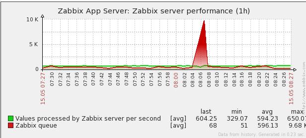

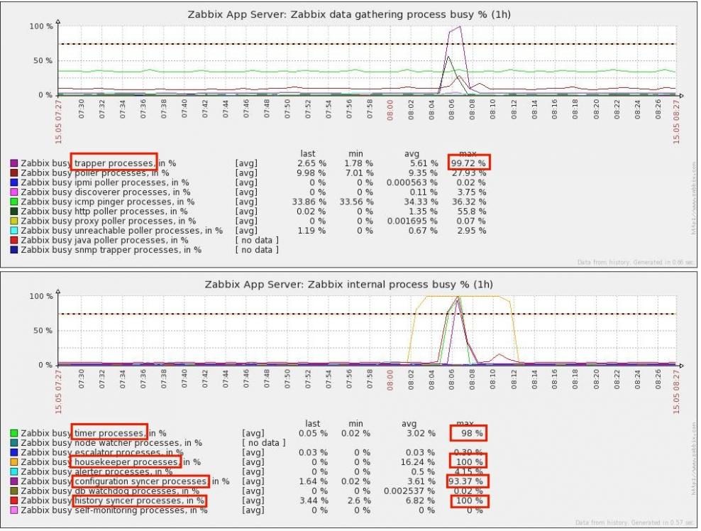

    I've managed to narrow this down a bit more... I think its unrelated to the frontend... Since around 8am this morning there seems to have been a rise in the trapper busy process from it's normal 20% to 100% and when it's peaking then the frontend is showing as offline...
    There have been no other changes other than the gui to display host inventory data properly...

      I can relate. I had that for about 5 minutes this morning. Mine seems to occur mostly when that pig housekeeper runs, and puts several processes at or near 100%. It also drives the Zabbix queue sky-high.

        I increased the number of trappers and the load decreased... During this period we had a load of servers offline due a network connection failure so they weren't reporting in... This led to a large queue, but I don't think this should overload the trappers... However, once the servers came back on then the trapper utilisation went back to normal...
