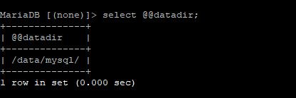

          On the centos server create a partition for the DB (/ data). I followed the instructions on how to change the mysql database directory. I validated it with @@ datadir inside mysql and it was correct in:
          : / data / mysql

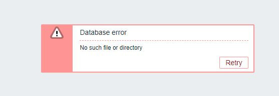

          But the web interface is not working for me now. shows me error:
          Database error
          No such file or directory
          I went to the php.ini configuration file located at:
          /etc/opt/remi/php72/php.ini and there add the new socket path and it looks like this:
          MYSQL_PDO
          pdo_mysql.default_socket = / data / mysql / mysql.sock
          MYSQL
          mysql.default_socket = /data/mysql/mysql.sock
          But it still doesn't work for me, what else should I modify?
          Thank you very much for your help.
          I leave here the error message that gives me and how is the directory of the DB after having changed it to the new partition.
          • Atsushi
            Atsushi commented
            It's a different question from the ones exchanged in this thread. Try the following setting.
            mysqli.default_socket = /data/mysql/mysql.sock

          #20
          Hello Atsushi
          Sorry for writing here, I'm new to this forum, I don't know it well at all, I only wrote in the first thing I saw, sorry again to All.
          But still validate in my php.ini file that is located in /etc/opt/remi/php72/php.ini
          there is that line is this way:
          ; Default socket name for local MySQL connects. If empty, uses the built-in
          ; MySQL defaults.
          ; http://php.net/mysqli.default-socket
          mysqli.default_socket = / data / mysql / mysql.sock
          But it still doesn't work, restart the httpd, even the server after making the changes but it doesn't work. Excuse me again. If you can help me with this issue, I would appreciate it very much.
          • Atsushi
            Atsushi commented
            I don't know how you are building your PHP environment, but if you have configured it to work using php-fpm you will need to restart php-fpm.

          #21
          Thanks Atsushi, I have PHP 7.2 installed and I have made the changes in the php.ini file and after that I have restarted the service and even restarted the server but it does not work the same for me.
          In the same way, thank you very much for the help and sorry.
