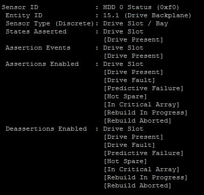

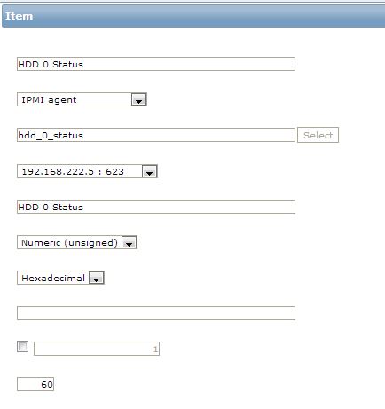

    Have IPMI working with a few fans and temp's and I'm trying to setup monitoring of hard drive status Discrete sensor
    See image sensor Zabbix for my setup in zabbix
    and
    See image sensor info for output of ipmitool
    Currently getting - Status not supported
    sensor or control HDD 0 Status@[192.168.123.25]:623 does not exist
    Any ideas?

    try the same via ipmitool
    I've found that sdr lists things that I can't seem to get via ipmitool, so Zabbix probably can't get it either. Is it Dell hardware?

      Update
      Got it working by adding the 0 to the end of the descreet sensor name
      It is not stable however as the sensor keeps going unsupported
      Will monitor using custom windows log
