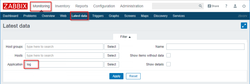

    Wait 100 seconds for the configuration to sync with the database. Then look under Monitoring -> Latest data
