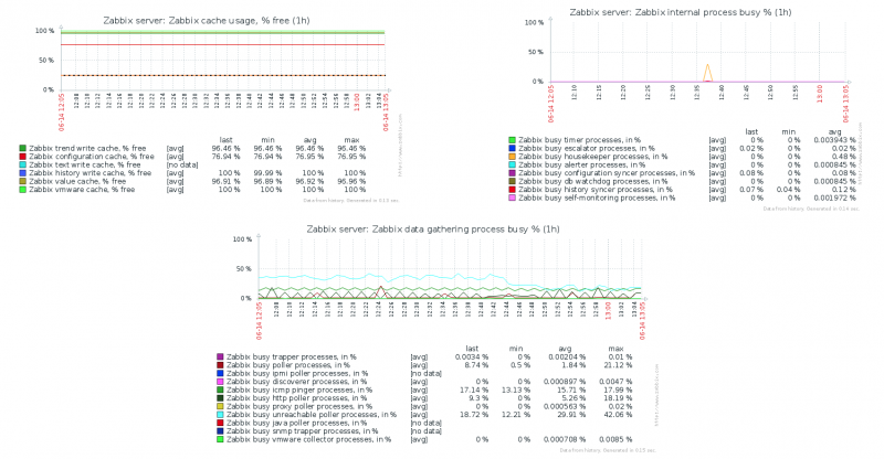

      Could you provide the following graphs?
      • Zabbix server performance
      • Zabbix internal process busy
      • Zabbix data gathering process busy
      • Zabbix cache usage
      • Number of unreachable hosts/unsupported items

        Ok so first thing then is, the documentation is inaccurate, unreachable pollers throttle constantly for ANY unreachable host of ANY type. I proved this by disabling a couple AWOL printers. It appears that devices offline for service are a serious impact on this, and there needs to be a performance setting somewhere to mitigate this. One down printer should not throttle the server at default settings. I don't think I should need 50 pollers running in an enterprise because they each throttle one device that may be offline for any number of fine reasons.
        In regards to the graphs, I'm immediately curious about the mention of one that would show unreachable hosts and unsupported items. That sounds very useful, but it does not exist from what I see. Given the other graphs also did not exist until I found a template to add to the system, I'm guessing it's a similar thing. Better yet, some way to list out such items for investigation and clean up. Can you point me to such resources?
