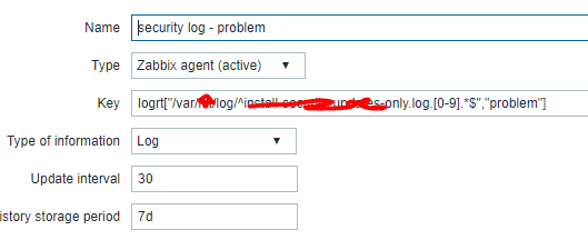

        this is the item, again it works but i have this issue:
        1. if i manually change old log to have "problem" in it - it fire trigger
        2. if i make new clean log after the problem one - still item is not cleaned and shows problem
        see atteched
        • Atsushi
          Atsushi commented
          If you edit a past log file that matches a regular expression, it is judged that it is the latest log file, and it will read the past log file from the beginning again.
          If you want to edit past log files, please move to a different directory before doing.
          I think that it is a trigger setting problem that the trigger remains obstructed.
          If filtering is not done at the time of log acquisition and the character string "problem" is included in the trigger, it may be easy to set it as a failure.
          However, if you do not want to filter it, pay attention to the size of the log to be saved.
