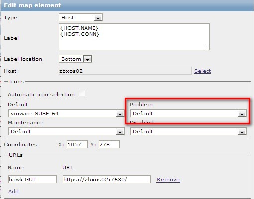

            Thanks for the replies, even I could not solve my problem. I'll show some pictures, maybe this will help solve my problem.
            I added my device with ICMP monitoring. Note that my device is down (note the red Z in the "Monitoring" column) (picture 1).
            Added this host on my map. In case of problem, the icon changes to the cloud. (shown in picture 2)
            However, the Monitoring menu-> Maps-> Map My device is still ok. (picture 3)
