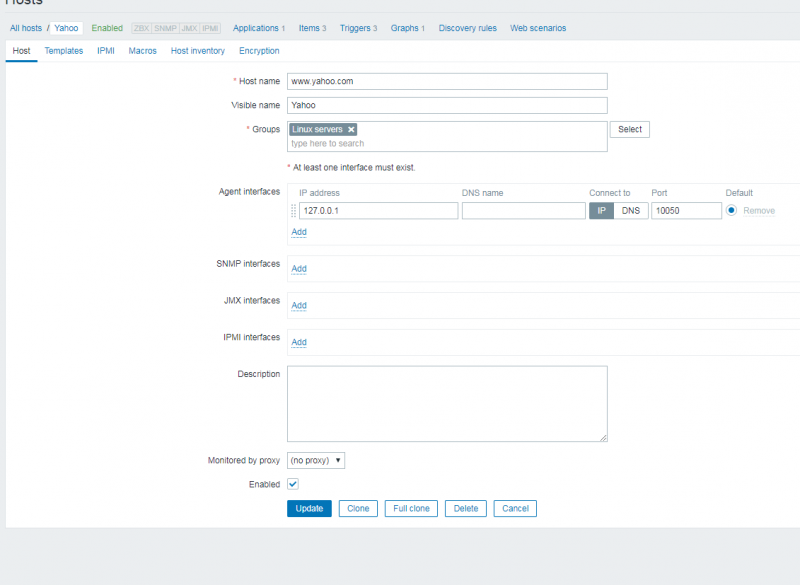

        It seems for icmp ping template, if these's no target IP specified, icmpping will use interface IP (agent or snmp or jmx or ipmi) as target IP.
        In above example, no matter what hostname or IP address filled in Host name, icmp latency will be 0.1ms.
        As long as I fill the target IP in any interface IP address option, i will get the right icmp latency.
