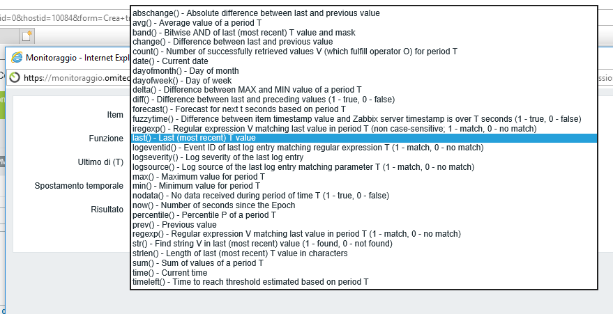

    Hi Guys,
    using Zabbix 3.4 on Ubuntu 16.04 I translated Zabbix frontend in Italian language reconfiguring the locales.
    The only stuff that is not translated is the expression constructor of the trigger which is still in English.
    I am trying to follow the steps ad described in the Wiki (https://www.zabbix.org/wiki/Translat...ating_frontend) about the compile of the file "frontend.po" but I am stuck at: locale/make_mo.sh because I can't find "locale/make_mo.sh"
    Thank you
