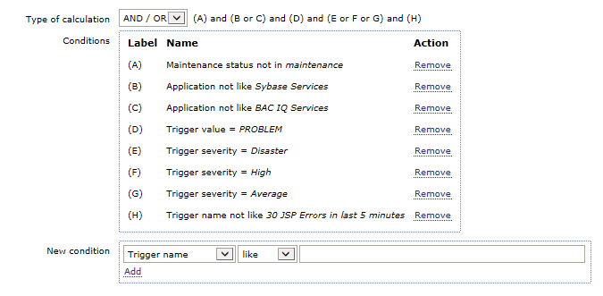

    I'm currently on Zabbix 2.2.3 release. I'm trying to setup a notification action based on certain conditions. Basically, I don't want any notification is the triggers were from a certain application. I have tried using "application not like xxxx" and some other conditions. It doesn't seem to work.

      Basically, I'm getting triggers that I don't want. The triggers are meant for engineering.
      I don't want triggers that belongs to Sybase application or the other application.
      I have attached a screen shot of the conditions.

        You have a classic "Or Knot", your (not b or not c) is always true. If its b, it's not c and vise versa.
        Try (not b and not c)

          I see what you mean. However, if I change the "Type of calculation" to AND, it will mess up the Trigger severity. So, I updated the Trigger Severity to be greater than certain value.
          Thanks for the help.
          Let see if this will work.
