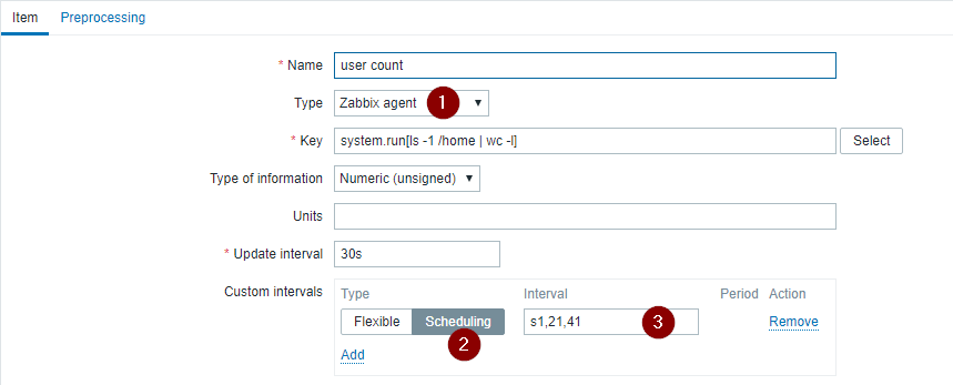

    Hello sage12,
    Zabbix passive checks are distributed evenly. When it comes down to Calculated items, for high precision you must use item type Zabbix agent together with Scheduling interval.
    For example all input data must be configured to fetch in seconds: 1, 21, 41.

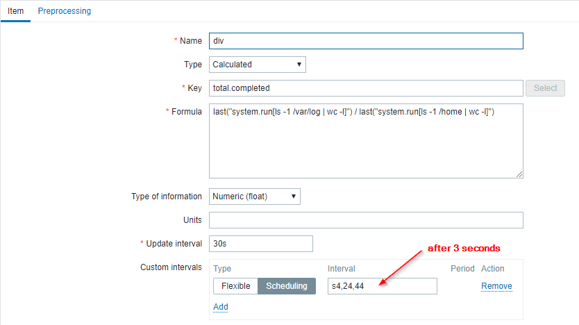

    For really huge instance the calculatation must be executed after 3 seconds:
    P.S. In performance counter case you must escape the double quotes. See bottom of the page https://www.zabbix.com/documentation...pes/calculated
