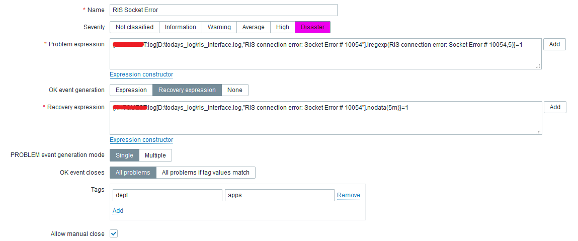

    Hi Symon,
    I use a Recovery Expression to close the problem if it has not re-occurred in the last 5 minutes
    • Symon
      • Jan 2019
      Hi Boye, thank you very much for your reply. So, as I was running version 3.0, my trigger menu didn't have the 'Recovery expression' option. That encouraged me to upgrade. If I'm gonna upgrade, might as well go to the latest, right? 4.0 here I come. Anyway, after a brief battle with selinux*, I'm back in the game with 4.0. This provides me with your solution, but also a better one as well. Triggers in 4.0 support "Allow manual close" which, I now realise, is what I wanted all along. I want to make sure I see snort alerts, and this means they stay displayed until I manually OK them. The upshot is, although I didn't use your solution per se, it did lead me to what I actually wanted. Thanks again, and all the best!
