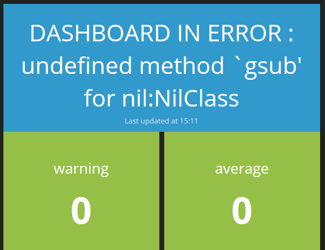

    tatapoum,
    Thanks! I have downloaded it and installed. Ran the dashing start and I'm actually getting way more info than I did before. It's displaying a dashboard error as follows:
    Any ideas on this?
    Thanks,
    Dawid
    • tatapoum
      • Jan 2014
      • 185
      #47
      It means it cannot find your Zabbix groups. Did you edit the zabbix.rb and put the right group names in the SCREENS hash? Does your user have the permissions to query these groups ?

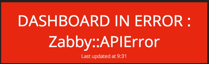

              #51
              Https...?
              Thank you for providing the dashboard. After installing it, I found the following issue...
              When the only access to Zabbix is via SSL (https), the API call made by dashing is not returning values, and is reporting an error (see attached picture). Any suggestions on how to configure dashing to use SSL? Or am I missing something basic...?
              • Jason
                • Nov 2007
                • 431
                #52
                I use it for SSL and I've just specified the new URL... I think there is another gem you need to load for SSL and I think I had it specified for something else although can't look it up now.
                In the rescue routine at the bottom of the file.
                add in a line
                puts "#{error.message}: #{error.backtrace} (#{error.class})"
                and it should give you more information... That should appear in the thin.log file in the log folder if you're using the thin scheduler.

                          Dashing with Zabbix 3.0
                          Hello there
                          Did anyone of you guys managed to get Dashing working after upgrading Zabbix 2.4 to 3.0? I get following error: Undefined method 'gsub' for nil:NilClass.
                          Thanks for any advise.
