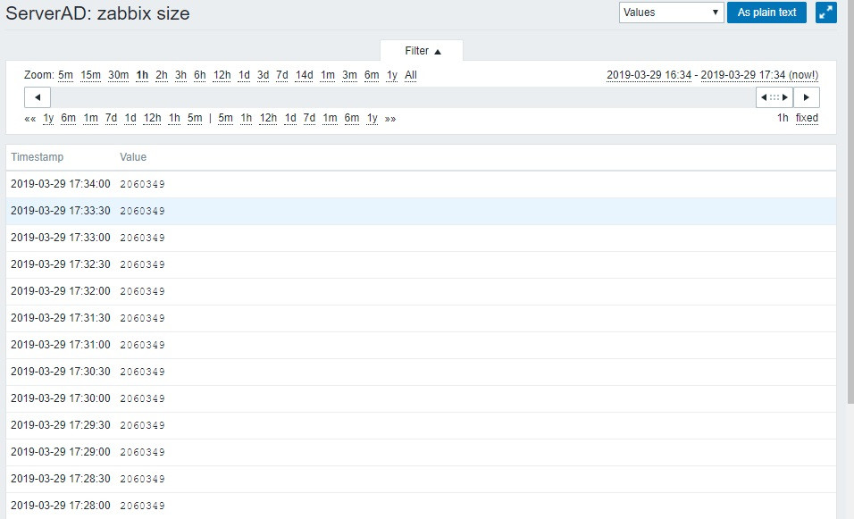

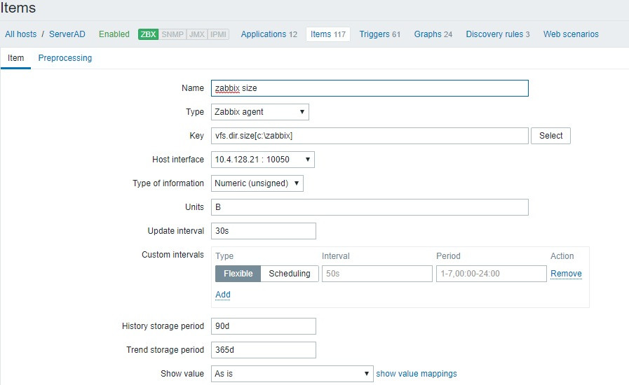

          Well, I created the same item. Zabbix 3.4.14 on CentOS Linux release 7.5.1804 (Core), Agent 3.4.6 on Windows Server 2012 R2.
          The item works. In both mode - active and passive.

              You need to change the units of item to B. What is the status of the item - enable or not supported?
              • MichaelF
                • Feb 2019
                • 66
                #37
                You need to change the units of item to B. - that didn't help.
                What is the status of the item - enable or not supported? - enabled.
