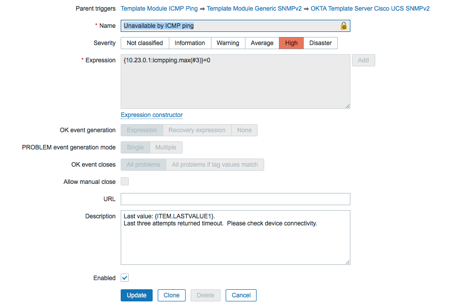

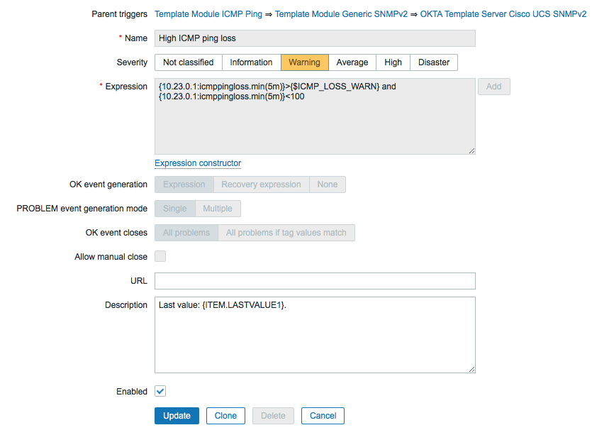

    I'm novice of Zabbix. I have configured my Zabbix server and is perfect, but the notifications email and dashboard are too slow, I wait also 3 minute for a notification of a switch shutdown or a Windows server shutdown.
    Anyone have a idea?

    Please post screenshots of Item and Trigger configuration
    • pisolux
      • Apr 2019
      here is an attachment

        If you look at your trigger configuration, it is set to only trigger the event if you have 5 minutes of loss greater than your treshold, so the minimum amount of time to trigger the event would be 5 minutes. If you would like to receive these notifications earlier you should decrease the time from 5m to 1m or something that fits your needs (although you have to bear in mind that as you use small tresholds your triggers will be come more sensitive and could sometimes alert before what you would like).
        The second screen similar, because you are configuring the trigger to trigger if the last 3 values are 0, so the minimum amount of time to trigger would be 3 x (item fetching time).
        • pisolux
          • Apr 2019
          Thanks, you fixed my trouble
