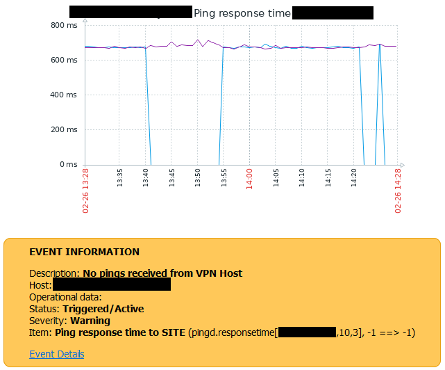

          Found several topics across the forum where people are asking for such a function for quite a long time already. Also wanted to have this myself and decided to do some fun coding also to get a better knowledge of the internals of Zabbix.
          I've just finished coding a working "proof of concept" PHP Webhook based Media Type called "MailGraph" that picks up the event, finds out if there is a graph associated and sends out an e-mail with the graph.
          The PHP script fetches the objects (item, host, event, graphs) via the API, logs in to Zabbix, grabs the graph and composes a template based e-mail.
          If you're interested I can post the code/instructions on Git after polishing the code a bit more?
          • hoppa
            • Feb 2021
            • 17
            Example how this looks like (taken from the actual e-mail sent out):
Name:	26-02-2021 14-32-12.png

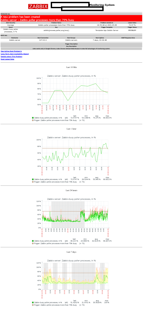

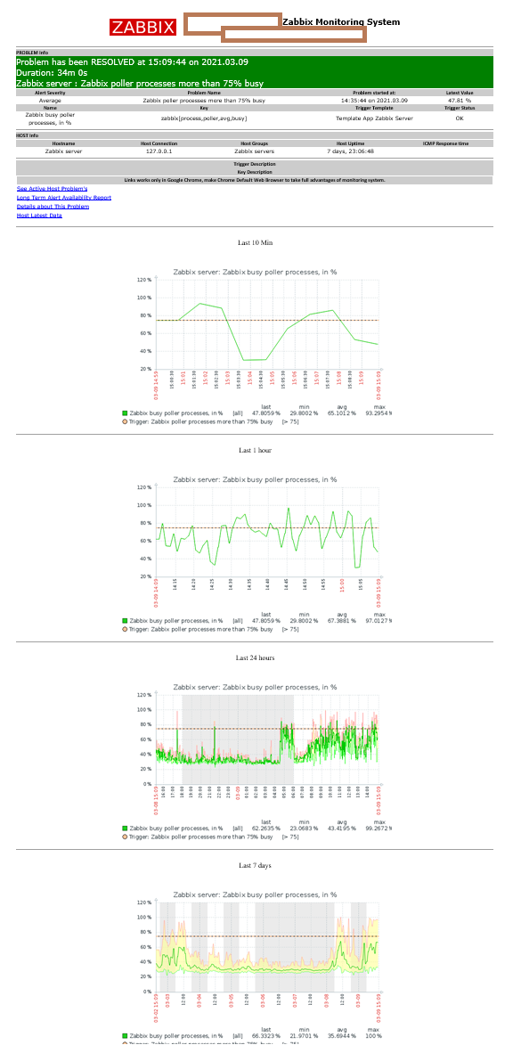

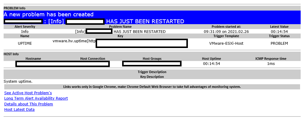

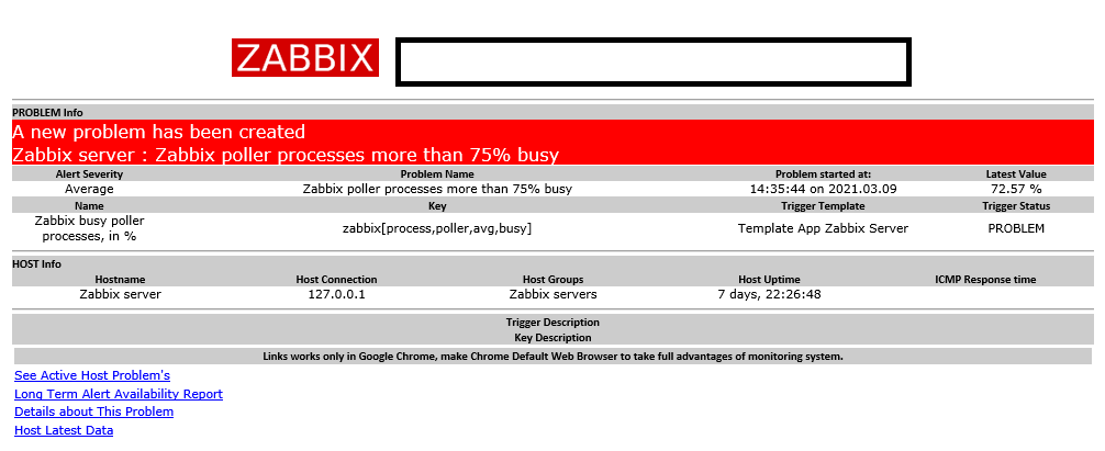

                        Hello
                        I had the same problem here.
                        Was able to figure it out.
                        There is needed info in the forum to create alerts like this I believe.
                        Check it out, screenshots of mail alerts attached.
