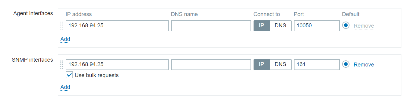

    You can monitor one host with both Zabbix agent and SNMP. Create both the Zabbix agent interface and the interface for SNMP in the host configuration.
    Check the values that can be obtained from SNMP server on Ubuntu server using snmpwalk command etc on Zabbix server. If you know the OID of the value you want to get, create an item of type SNMP Agent.

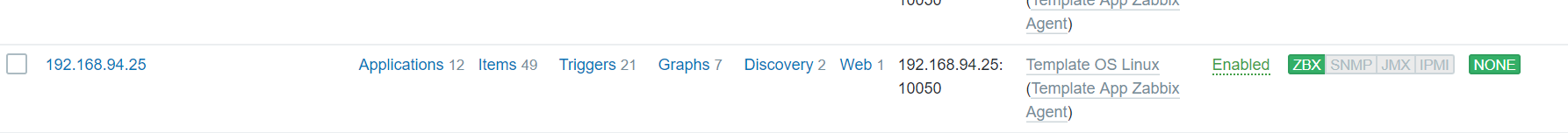

        HI Atsushi,
        Thank you so much for the reply.
        - Can you get the value from snmpd by snmpwalk command? No that's the issue
        - Have you added a host SNMP interface? Yes have added the interface
        - Did you create an SNMP item? Yes
        - Is the community name the same as the one set in snmpd? Yes Communit String is Same
        But SNMP not showing an any error, it still grayed like not configured. If it works it should Green otherwise it should Red.
