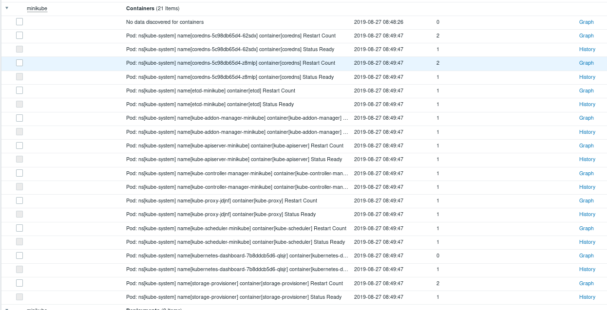

          Just know some progress
          I had some issues to get it running on centos, better succes on archlinux ( my favourite distro ) - I had to move the config files of k8s(minikube) and cert files of k8s(minikube) to location accessible to zabbix and it started working in full ( onlypartial success with redhat ). At lest it gives out something - maybe this could a way how to improve kube/openshift monitoring. So far there wasnt anything in athe alfa version of 4.4 event if it was mentioned in the roapdmap
          See screens from latest data - its from minikube cluster - so not much like a productional environemnt - first test - when I deleted the pod , ne was scheduled , autodicovery rule picked up the new one nearly immediatelly ( 1- 2 min ) and removed the deleted one in simmilar time.
          If anybody is curious how to setup ping it here, even more if somebody is perl guru maybe this can be improved somehow to get the cpu, mem, disk utilization of the pods.
          Click image for larger version  Name:	containers.PNG Views:	2 Size:	109.4 KB ID:	385071
          Click image for larger version  Name:	deployments-nodes.PNG Views:	1 Size:	67.4 KB ID:	385069

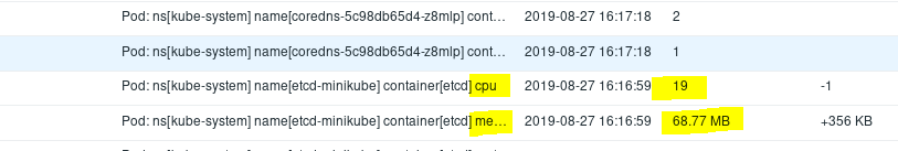

              pros:
              ive managed to start collecting cpu and memory metrics via metrics-server - seems possible - cpu is in milicores

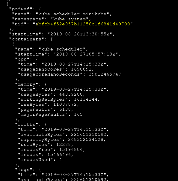

              to do ( if possible ) :
              obtain disk usage per container from API ( warp10 I can see some section with uuid there as well - is ithe one youre looking for)
              kubectl get --raw /api/v1/nodes/minikube/proxy/stats/summary

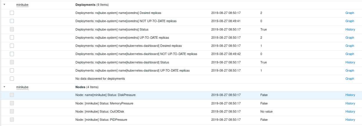

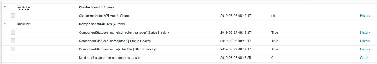

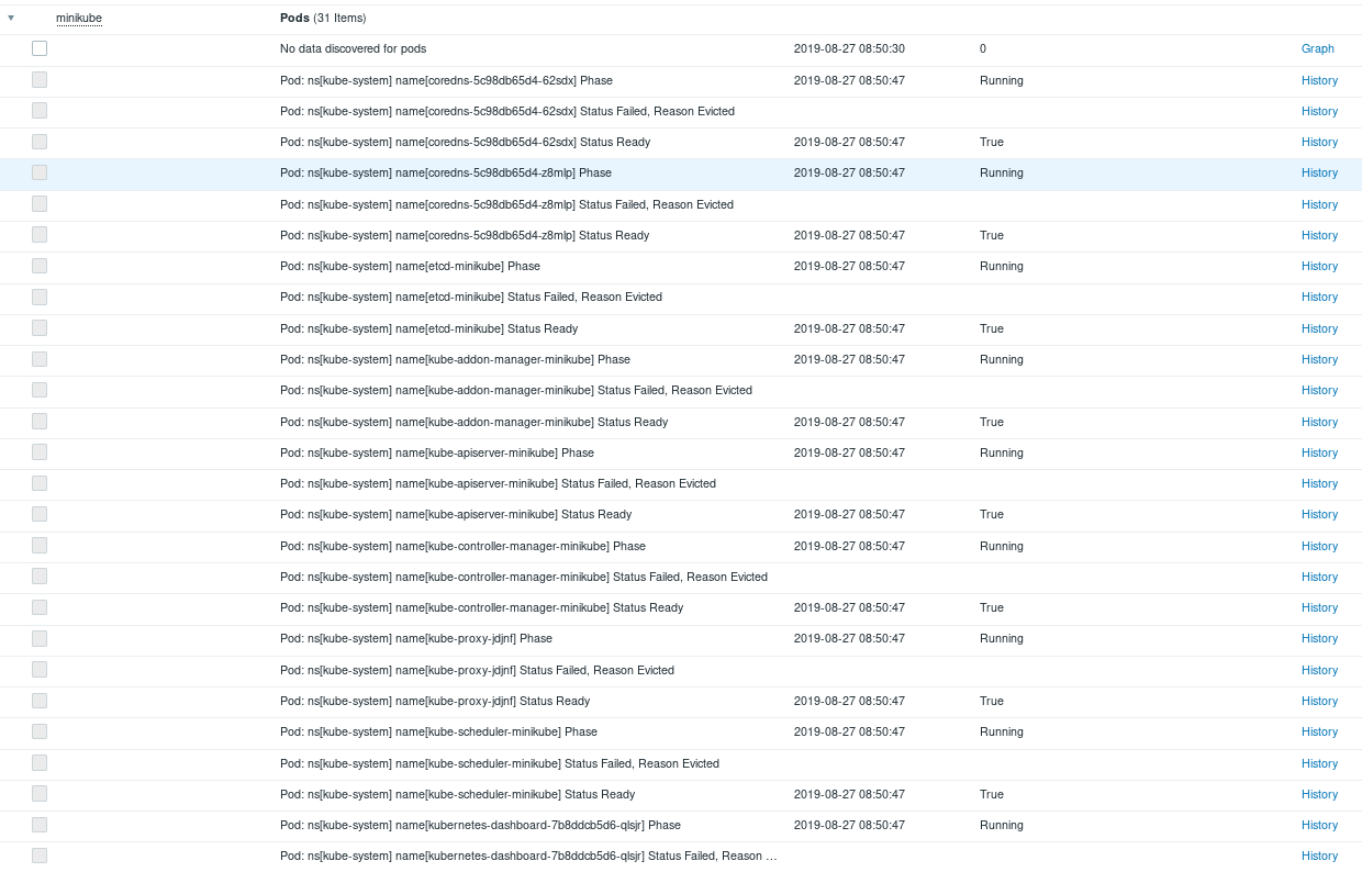

                So this is wahts going on:
                tested on minikube and minishift ( point 1 - 7 seems working pretty OK )
                1. containers
                - pods are being discovered also with all conatiners ( fixed )
                - readiness status and restart count is working
                2. api services are being discovered
                3. deployments
                - desired replicas
                - not up to date replicas
                - status
                4. node
                - disk pressure
                - memory pressure
                - out of disk
                - pid pressure
                5. pods
                - phase
                - status failed, reason evicted
                - status ready
                6. components statuses ( etcd, scheduler,....)
                7. cluster health
                8. getting the cpu ,memory, storage usage per container - needs some work - anybody willing to help with json, autodiscovery....

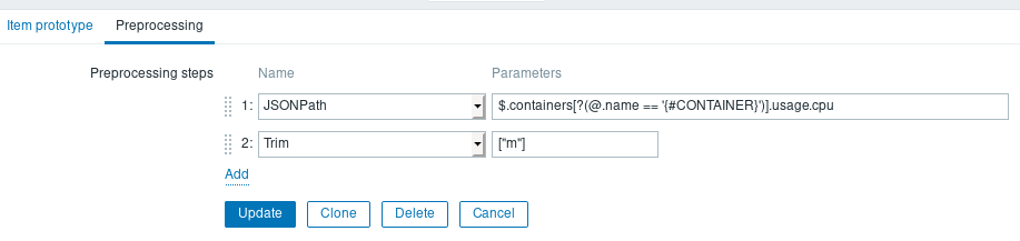

                  1. step master item ( basically get the data on pod with container as quoted bellow )

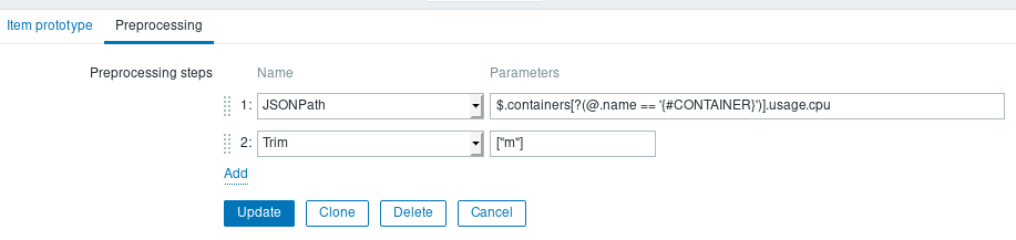

                  2. step dependent item for with some json ppath preprocessing that should retrieve the number for cpu or memory usage

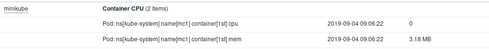

                  3. step 1st run of LLD - container 1st metrics are present
                  4. step second run of LLD - container 1st metrics are replaced by 2nd condainer metrics and it stays like this

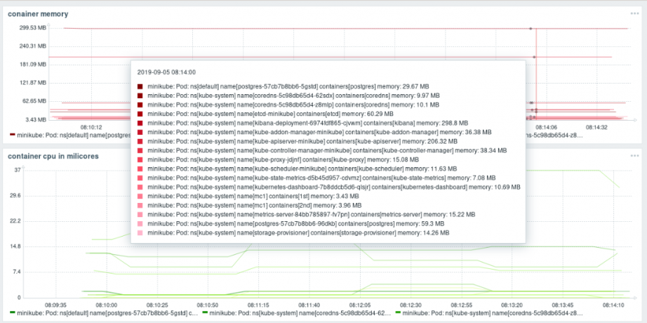

                              thanks, it seems to be working - metric make sense - though I have a a suggestion for you...
                              for now I have manage to get the metric data for cpu and mem per container in to zabbix - basically for every pod there is a kubectl call pod with some json prepropcessing ( as the namespace, pod, container ale already autodicovered - {#NAMESAPCE},{#NAME},{#CONTAINER} )
                              this is done as LLD - not so effective when it comes to number of kubectl call, but works ( for every discovered pod there is a kubectl call ) - see the graph
                              Click image for larger version  Name:	Capture.PNG Views:	1 Size:	353.2 KB ID:	385697

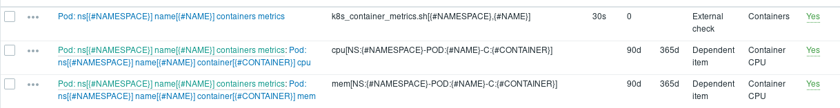

                              as of now I have this kind of setup
                              1. first metric fro the pods are being called ( 3rd value is just for the item key differentiation )
                              cat k8s_container_metrics.sh
                              #!/bin/bash
                              kubectl --kubeconfig=/etc/zabbix/kube.conf get --raw /apis/metrics.k8s.io/v1beta1/namespaces/$1/pods/$2
                              echo $3 >> /dev/null
                              item prototype

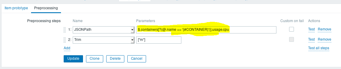

                              2. there is a jsonpath preprocessing for the obtained data ( if I knew how to write json path preprocessing for the whole data set based on those 3 macros it would be evene easier and no script will be needed )
                              basically this json path preprocessing goes through the data retrieved in step 1 and for every container ( rememebr the container name/macro {#CONTAINER} is already discovered and put in the context of namespace and pod )
                              similllary there is another item prottotype for container memory
                              if there would be a way how to cretae a json path preprocessing rule that will get from the full list that will more efficient way - mostly the work will be done by zabbix for this - not sure if thats possible though - the full output is full.txt in one of my previous posts
