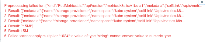

      not so bad news but still needs to be fixed
      memory usage can be reported in Mi and Ki ( what I observed so far ) - when the memory usage is reported in Mi obviously the preprocessing rule fails on step 6
      seem that solution could be java script checking for Ei, Pi, Ti, Gi, Mi, Ki suffixes and if doind doing the counting ( multiplication to bytes ) - anybody willing to write it ? guess it will take more for me than for somebody who can do it from scratch

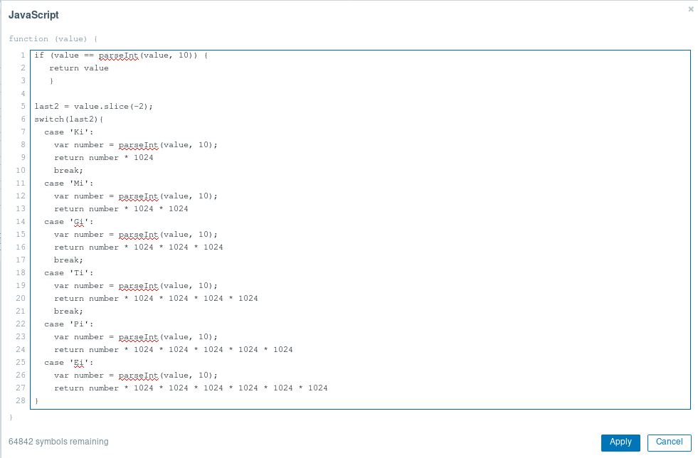

            so with a bit of googling last step of preprocessing in java script

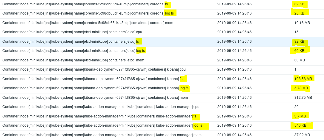

                  I was able to create a preprocessing steps with jsonpath that extract metrics for conatiners - cpu(usageNanoCores), memory(usageBytes), disk usage(rootfs.usedBytes), disk usage for logs(logs.usedBytes)
                  The strange thing is that actually Im not sure if the number represent what I think they do - especially for disk usage - the number are pretty low for etcd, coredns containers, better for kube-addon-manager and pretty reasonable for kibana
                  Am I reading it right that those number present the the usage of container ( the writable part ) as the image of the container is read only and can be mutual for for several container and so this is actually presenting the number of bytes that are used by the living containers except the image size?

                      - Im getting some data for containers
                      a) cpu is milicores ( doesnt say the utilization of cpu for the container - for example the the container can have some hard treshold how many milicores can be used - if such thing will be present then maybe some metric calculation will be done for utilization=current_usage/treshold )
                      b) memory thats pretty OK
                      c) fs usage - I'm not 100% sure it providing the data in full scope kibana looks promising - I think its like this that the container is using disk on top of the read only conainer image ( so its disk usage doesnt count to the running container disk usage ) in such case also the other numbers will be looking pretty OK as theyre default container with not so many changes on top their read only images - but there might other files that might count to the fs usage per container - Im kinda trying to sell the k8s api information - see rootfs and logs section in json output in my previous post
                      If you have any questions I've pinged you my email in messages
