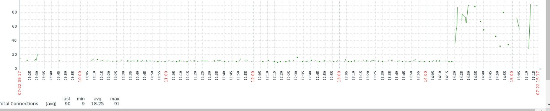

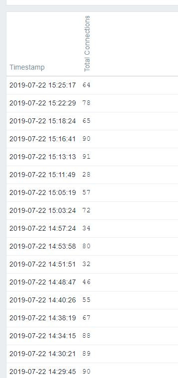

    Hi All,
    I am running Zabbix 4.0.7. As I have started adding more hosts, I am noticing that graphs for many items are not showing holes/gaps. I am using Zabbix to monitor firewalls, routers and switches. Current issue is on firewals (Cisco and Checkpoint).
    I am using SNMP OID to monitor the devices.
    I searched a bit on google and tried different things:
    1. Interfaces are set up already with 64-bit SNMP counter.
    2. Disabled use bulk requests.
    3. Change polling frequency to 5 minutes, 1 minute, 30 seconds. Nothing fixes the issue.
    Attaching the screenshot for the broken graph and value.
    Would appreciate if someone can help me out with this issue. What can I do to make the graph continuous. The issue persists with most of the new devices I add now.
