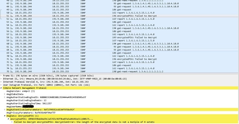

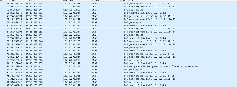

          We have the same problem,
          Then we decide capture traffic with tcpdump on zabbix ethernet interface and decrypt with wireshark using snmp user tables.
          The results are random bad formatted request that can't be decrypted.
          Ones because unexpected size (not multiple of 8), other because can't be decrypted with the key.
          Same result with new installed zabbix server on virtualbox test machine with only one snmpv3 device no bulk (~500 items).
          Zabbix version: 2.4.7
          Images attached.
