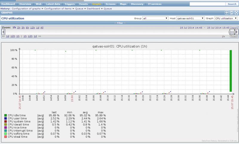

    Also, see the weird sparse data I am getting for the CPU (below screenshot). Looking at the agent's log file, it seems super busy checking the CPU, taking measurements every second - but this is not what I see when looking at the graph.
    It is noteworthy that the agent's host is doing OK (no CPU strain, memory good, network to Zabbix Server fine, etc). Same for the server: it's a pretty powerful machine with CPUs at almost 99% idle.

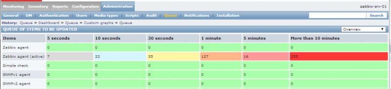

    Finally, the Zabbix Queue is pretty big. Some hosts are lagging behind of more than 10 minutes. I cannot explain why some hosts would be OK (under 30 seconds) and the rest lags. They are all using the same template, same route between agent and server, etc.
    The monitoring --> Overview tab is mostly green (only a few agents unreachable when the server failed to receive the ping for a long time)

          The Administration --> Queue - overview table now shows most of our items under the 5 minutes delay.
