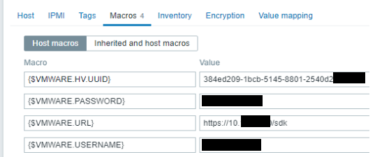

                            Old thread but this is not working for me.
                            I am still getting the unknown hypervisor UUID after confirming I have the correct Hypervisor UUID, username, password, URL.

                            SDK soap is running (on by default)
                            https://SERVERIP/sdk/vimService.wsdl
                            {$VMWARE.HV.UUID} is correct.
                            UUID is same both from esxcfg-info -u |awk '{print tolower($0)}'
                            ​and web (https://SERVERIP/mob/?moid=ha-host&d...are.systemInfo)
                            I have waited 24 hours.
                            I have tried removing the template and re-adding.
                            Tried with the VMware template, tried setting the variable as {$VMWARE.UUID} or {$VMWARE.VM.UUID}
                            Tried this on 3 hypervisors.
                            One esx 5.5 and 2 on 6.5.
                            Tried with both read-only accounts and ESX root account.
                            /etc/zabbix/zabbix_server.conf:
                            ​StartVMwareCollectors=5
                            ​VMwareCacheSize=64M
                            any thoughts or suggestions?
