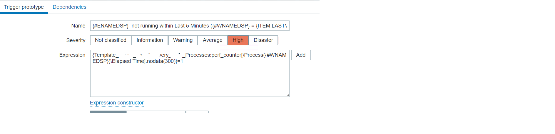

    I had a trigger prototype that created warning triggers successfully a long time ago. Now I had a request to include a critical alerts with a higher threshold. I cloned the warning prototype and changed threshold and created the trigger prototype. But it is not populating any triggers on the host. I have the discovery interval reduced to 30 Sec. Still its not working. What might be wrong?

      I wanted to change nodata(300) into nodata(600) with a Disaster. I tried cloning it and also by updating this existing prototype as well. Nothing is working!

                Thank you for all the help. I eventually realized that the script used for discovery is not working and nor it is throwing any error for the same on the zabbix console.
