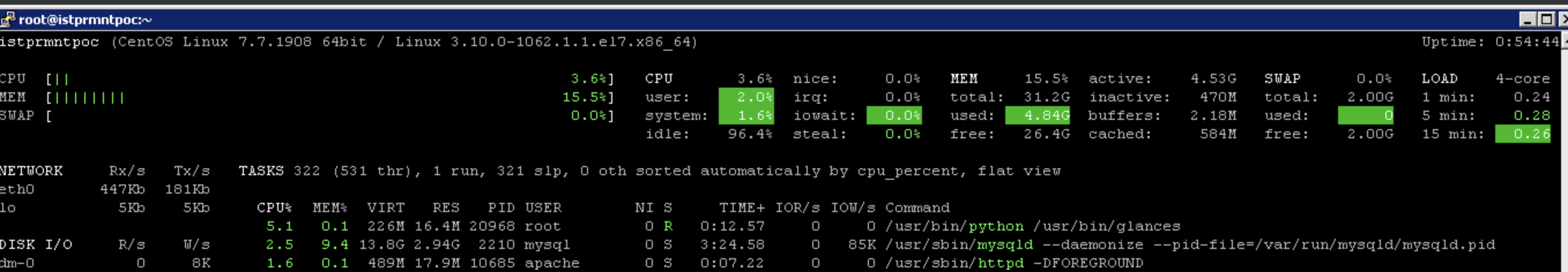

    I Today we faced a strange problem at office. The Zabbix server is installed with os Centos 7.4 & Zabbix 4.2.4 at vmware platform with a big full SSD storage backend.
    You can see in the picture that this VM has enough resources. 2 vcpu, 100 Gb disk for tests and 32 GB Ram.

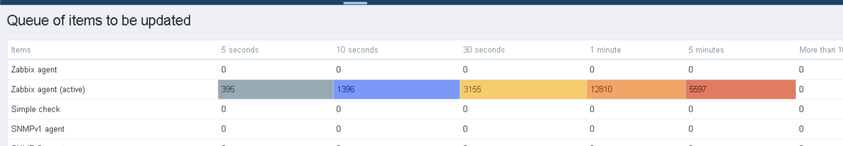

    All the agents are active agents and we plan to collect too much metrics at production environment. When we started with a few agents ( 105 agents ) we faced a strange problem. We noticed that the queues are full.
Name:	Screen Shot 2019-09-24 at 17.28.51.png
    As you can see , the queues are almost always full.

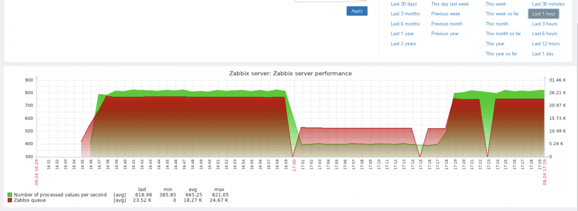

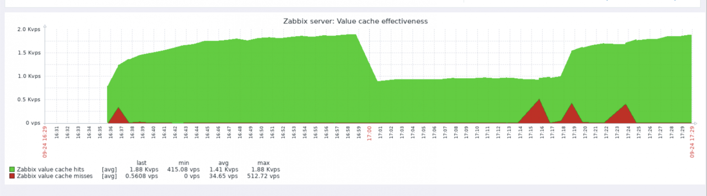

Name:	Screen Shot 2019-09-24 at 17.29.40.png
Name:	Screen Shot 2019-09-24 at 17.30.04.png
