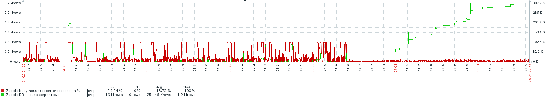

    Housekeeper Rows ever increasing
    A while back we had problems with Housekeeping being too heavy. We were able to resolve the issue by moving the database to faster storage.
    However, it seems that since that move we see an ever increasing number of "Housekeeper Rows". I am not quite sure what this is, but I guess it's rows in the Housekeeper-table that tells the Housekeeping process what should be remove when it runs?
    We are currently at around 5 million rows. Please see attached screenshot. You can see that busy housekeeper processes decreased when we moved to faster storage (that's my conclusion atleast).
    The high number and the ever-increasing nature worries me. What could be the problem here?
    Click image for larger version  Name:	2020-01-09 13_39_20-Window.png Views:	0 Size:	43.6 KB ID:	393035

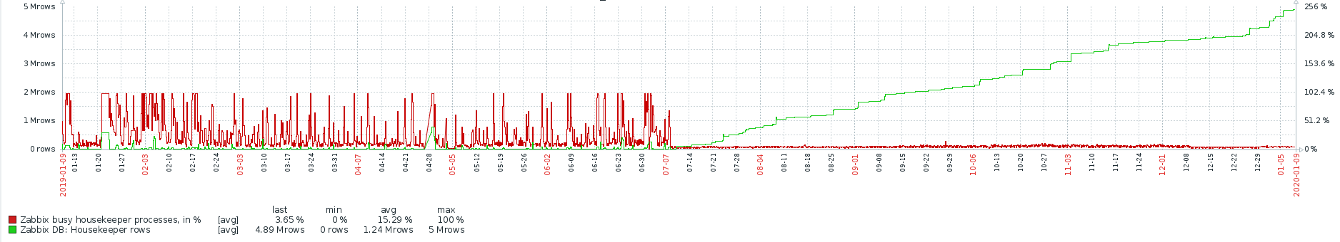

                    • CrashOverride
                      • Jul 2019
                      • 12
                      Here is a zoomed in screenshot of the graph. Before June 7th, the housekeeper rows were removed when the housekeeper ran, but that has stopped happening.
                      If the housekeeper struggles, to me that would be a reason for an increasing number of rows in the housekeeper table. But it doesn't struggle, so I'm still looking for an explanation for the never-ending increase.
                      Back when the housekeeper did struggle (before June 7th), it was regularly emptied when the housekeeper ran, even if it ran poorly/slowly.
                      This is what I think the housekeeper-table is: A list of stuff to clean up that grows over time until housekeeping occurs and then the cleaned-up things are removed from the list.
                      Maybe that's not what it is?

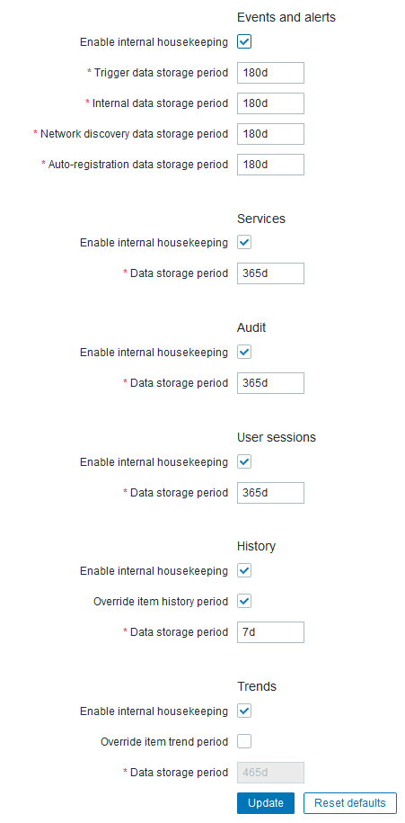

                          Housekeeping-settings:
Name:	2020-01-10 10_24_49-Window.png
