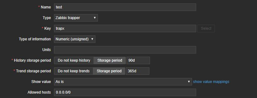

      Great, thank you for your answer, but I have problem with sending data using zbxsend. I always get error message
      ERROR:zbxsender:Wrong zabbix response
      Here is line from script
      HTML Code:
      send_to_zabbix([Metric('192.168.1.77', 'trapx', 1)], '192.168.0.100', 10050)
      192.168.0.100 zabbix server
      192.168.1.77 my pc
      Screen of settings
      Click image for larger version  Name:	tz.jpg Views:	0 Size:	37.9 KB ID:	395111
      I have checked zabbix_server.log, but I didn't find any information about possible problem. I wanted to try zabbix_sender to send some test data, but I don't know how to get it. In documentation, there is written that is located in bin folder, but I don't have it, and I didn't find any more information about this tool. Could someone help me, where could be a problem or how to debug it?

        Hi, you have incorrect port 10050 there, should be 10051 (= the port Zabbix server listens to, not the Zabbix agent port). Just delete the argument, it defaults to 10051.

            Thank you very much, you are great! The port was problem. In the list of hosts there is interface 127.0.0.1:10050, this is why I put there wrong port. I have also found zabbix-sender, I was looking for zabbix_sender according to documentation.
