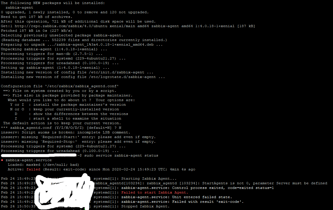

    Hi there,
    installed Zabbix agent (4.0) on Ubuntu 16.04, but noticed agent is off. Once I enable it, it stays as running for a minute or two and is off again.
    Decided uninstall (by this link http://ashoktutorials.blogspot.com/2...om-ubuntu.html) and install again, but now is failing installing back:
    what can be done so I could re-install it again?
  • tim.mooney
    • Dec 2012
    • 1436
    Look at the first line of messages that systemd has reported from the failed startup of zabbix-agentd. zabbix-agentd is telling you that your agent configuration file is missing required settings. Fix the config file so it's appropriate for your environment, and try again.
