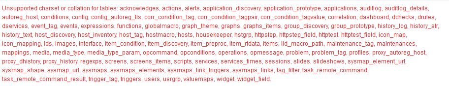

            I think i may have broken the tables in the database. I stopped the Zabbix server service and then ran the alter command on the zabbix database unfortunately seems like the tables now need to be changed also as i am getting the following error on the web page
            "Unsupported charset or collation for tables:
            acknowledges, actions, alerts, application_discovery, application_prototype, applications, auditlog, auditlog_details, autoreg_host, conditions, config, config_autoreg_tls, corr_condition_tag, corr_condition_tagpair, corr_condition_tagvalue, correlation, dashboard, dchecks, drules, dservices, event_tag, events, expressions, functions, globalmacro, graph_theme, graphs, graphs_items, group_discovery, group_prototype, history_log, history_str, history_text, host_discovery, host_inventory, host_tag, hostmacro, hosts, housekeeper, hstgrp, httpstep, httpstep_field, httptest, httptest_field, icon_map, icon_mapping, ids, images, interface, item_condition, item_discovery, item_preproc, item_rtdata, items, lld_macro_path, maintenance_tag, maintenances, mappings, media, media_type, media_type_param, opcommand, opconditions, operations, opmessage, problem, problem_tag, profiles, proxy_autoreg_host, proxy_dhistory, proxy_history, regexps, screens, screens_items, scripts, services, services_times, sessions, slides, slideshows, sysmap_element_url, sysmap_shape, sysmap_url, sysmaps, sysmaps_elements, sysmaps_link_triggers, sysmaps_links, tag_filter, task_remote_command, task_remote_command_result, trigger_tag, triggers, users, usrgrp, valuemaps, widget, widget_field."
            I tired running the same alter command on some of the tables but they are still showing up in the error message. Monitoring to see what is broken

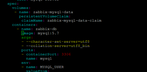

                    Is this a bug ? happens to me also when I upgrade zabbix containers from 4.4.5 to 4.4.6

                      • gofree
                        • Dec 2017
                        • 400
                        Solved, had to add args with proper settings - now the message is gone.
Name:	Annotation 2020-03-11 081108.png

                        • gofree
                          gofree commented
                          i did add those lines to my deployment file , specifically in mysql section
