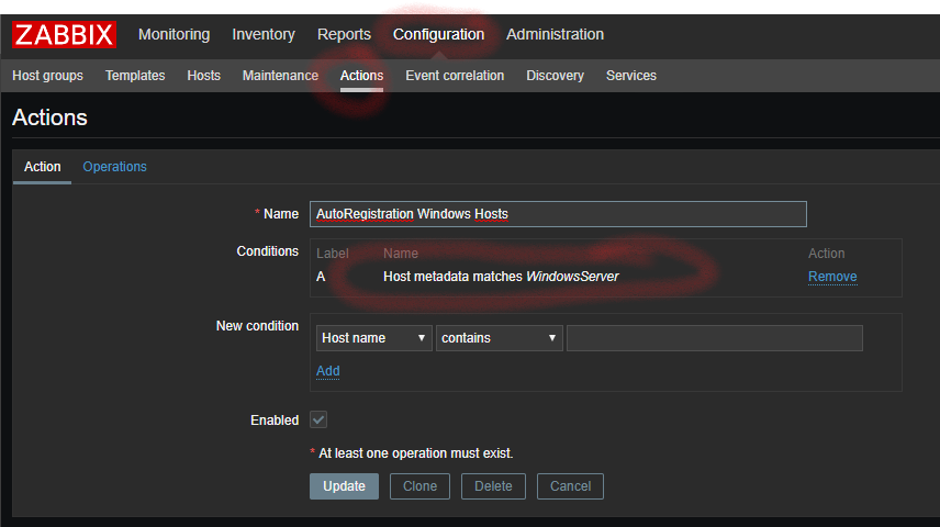

    Just installed the agent on the Windows-Servers and added the "Host Metadata=WindowsServer" for the Autoregistration

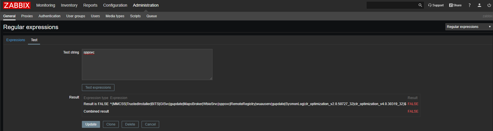

    Changed the regular expression and waited more than an hour?
    If the template you are using is "Template OS Windows" provided as a standard, the discovery process (Windows service discovery) in that template will be executed at hourly intervals by default. In other words, the monitoring items and triggers of each service set in the discovery process will not be reset until one hour has elapsed.
    If it doesn't improve after more than one hour, the regular expression specification may be incorrect. Tell me in detail how you have set the services and regular expressions you want to exclude from monitoring.

      Detailed way how i have changed the regular expressions:
      Looked for the "problems" like 'Service "sppsvc" (Software Protection) is not running (startup type automatic delayed)" or "Service "MapsBroker" (Downloaded Maps Manager) is not running (startup type automatic delayed)" in the "Monitoring - Problems Section".
      After that i went to Administration, General, Regular expressions and edited the "Windows service names for discovery". I used the default Expression type which is pre-configurated.
       [TABLE]
      [TR]
      [TD]^(MMCSS|gupdate|SysmonLog|clr_optimization_v2.0.50727_32|clr_optimization_v4.0.30319_32)$[/TD]
       		[/TR]
      [/TABLE]
      I just added every service i want to exklude within two "|servicename|" like this:
      ^(MMCSS|TrustedInstaller|BITS|GISvc|gupdate|MapsBroker|WbioSrvc|sppsvc|RemoteRegistry|wuauserv|gupdate|SysmonLog|clr_optimization_v2.0.50727_32|clr_optimization_v4.0.30319_32)$
      Expressoin type is: Result is FALSE; Case sensitive is checked
      When i test the expression with the service "sppsvc" i get the result FALSE as you can see in the screenshot below.
      Thats all i have done (i also tried to add a new expression like in the posted links from my first post)
