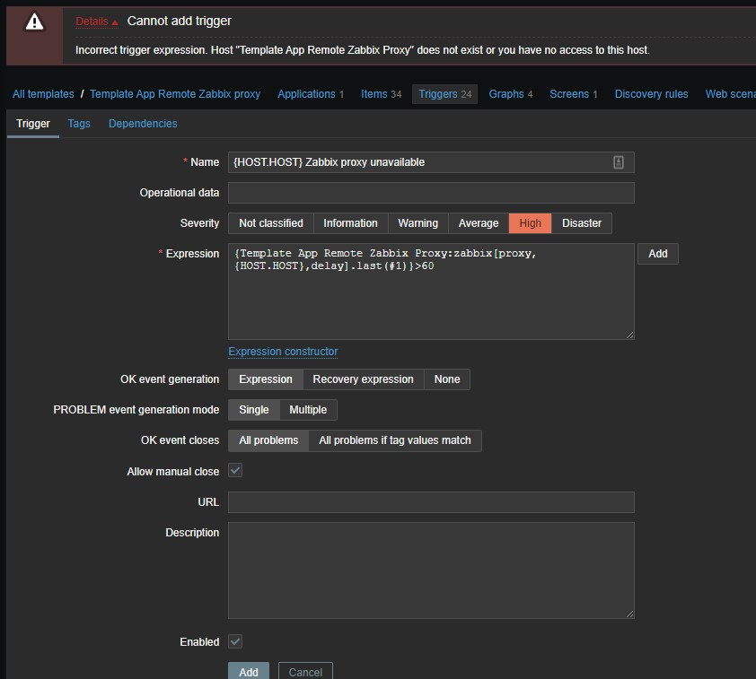

          This is what's happening for me.. Any ideas? Obviously I don't want to hardcode a proxy name in there. I need it to be dynamic so it can be applied via the template to multiple remote proxies without having to specify the name for each. Also i use remote app proxy template since these are all remote of the server in the NOC.
          I figured it out, gotta love CASE SENSTIVE issues..
