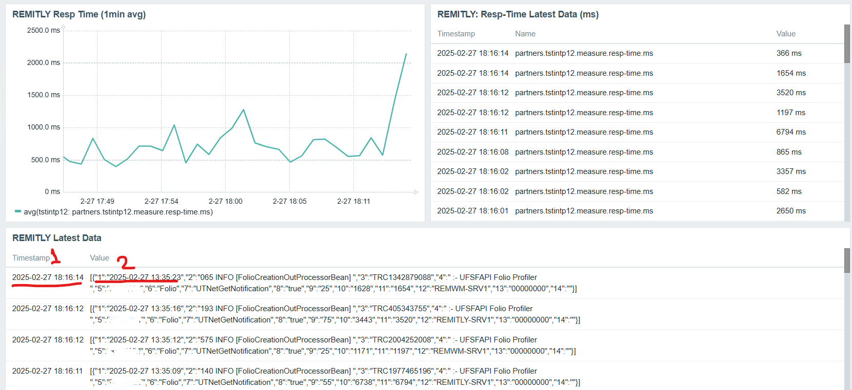

    • quixote
      • Feb 2025
      any solution for this case ? I just started to use this log monitoring, and I do have same problema. In the image below, the graph is using time stamps (1) and I need to log-file local-time (2)
