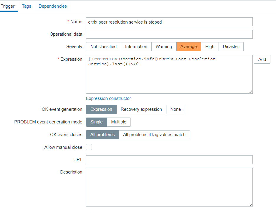

    I have a item for monitoring windows service.
    the key is service.info[<service>]
    the key return 0 that is running.
    Then I create a trigger for the service.
    The expression of the trigger:
    {ServerName:service.info[<Service>].last()}<>0
    If the service monitoring return isn't 0, it will show alarm.
    When the service has been stoped, the Dashboard of zabbix show the alarm.
    But when the service has been started, the alarm is still in the Dashboard.
    what do I should?

    Time may pass between the start of the service and the moment when zabix receives new data. In the data item settings, see how often it is updated and whether there is any preprocessing with discarding values. Also look in the trigger settings - it may have some other recovery expression set in it, for example, with a delay.

      The Update interval is 1m.
      I don't have configuration any recovery expression.
      This is trigger configuration

        Look at the data itself - do you get it? Look at the state of the data item to see if there are any error messages. Note also the state of this host.
