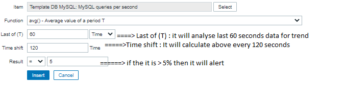

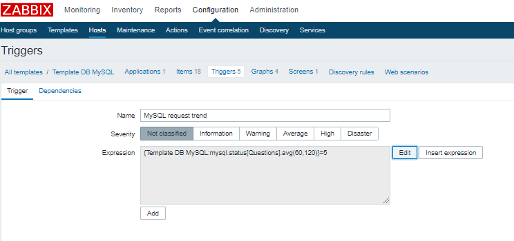

      i am testing this on one database to see if this works. Following below steps can you please confirm if this is right.
      1) added trigger (Template xxx -> add Trigger -> Expression -> Edit
      2) added
      i have added comments on "zabbix_2" image, let me know if the assumptions are right.
      Please refer to below attachments for reference
      Thank you

        I meant something else - using a formula in a trigger expression that contains multiple accesses to data elements.
        One with current data , the other with time-shifted data.
