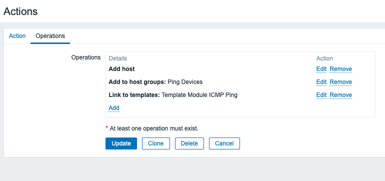

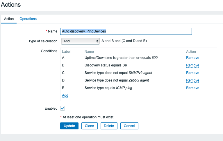

    My latest Action configuration which is not working (still adding hosts with Zabbix Agent and SNMP "agents")
ID:	402625Click image for larger version

    Inspection services are independent from each other.
    As soon as the service is detected, the action is called.
    At this action it is useless to use the results of other checks - the action does not know about them!
    • ivanhansson
      • May 2020
      • 11
      So how to I separate only PING-able devices to apply to the Action rules and avoid that hosts with other services running will be added to certain groups and with templates that is not for them?
