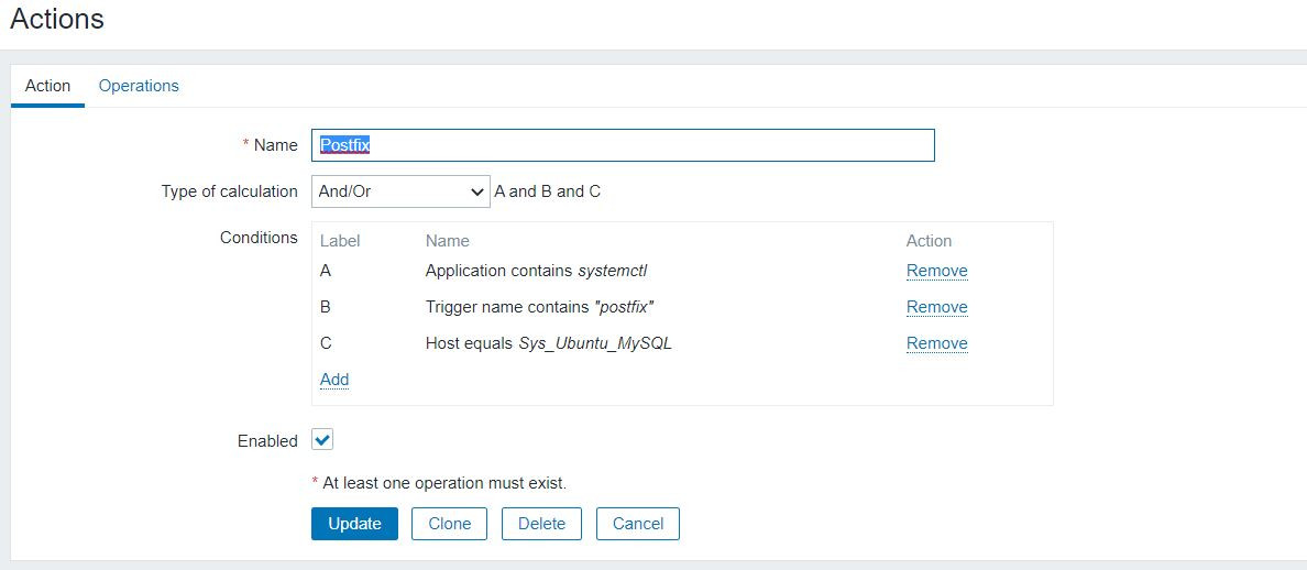

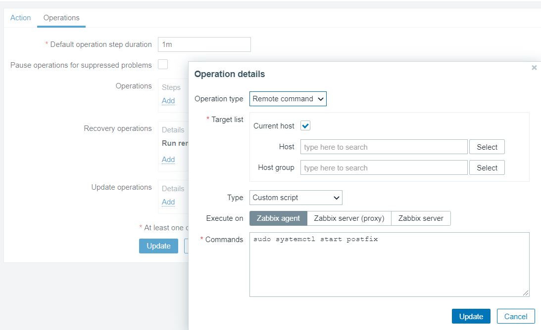

    And when I shut down the postfix service I have an alarm. I configured an action to Zabbbix automatically start the postfix service when it is down:

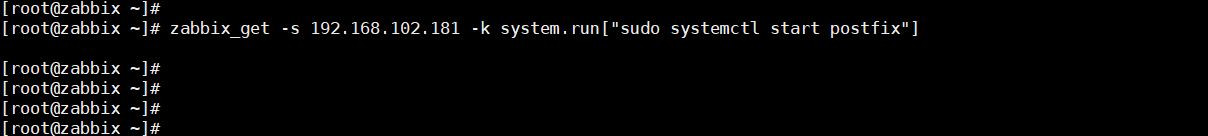

    But the situation is when the alarm is active no action is launched by Zabbix, it seems like the condition is not working because I can launch the same command form zabbix server command line and It works because the service start but never zabbix run this command itself.

      I can test the status of service or stopped it or started it from Zabbix server CLI:
      So, there is not any permission problem.

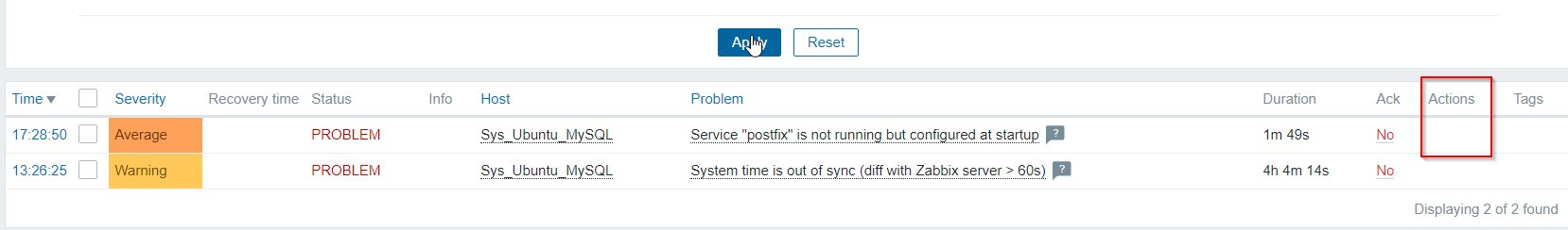

        I think you're on the right track, sujiga , with the idea that the problem is your action conditions, not what the action is actually supposed to do. As you've identified, if there is nothing in the "Actions" area for the Problems display, then Zabbix hasn't taken any action, probably because something about your conditions does not match.
        In the "Applications" box for the item, is "systemctl" set?

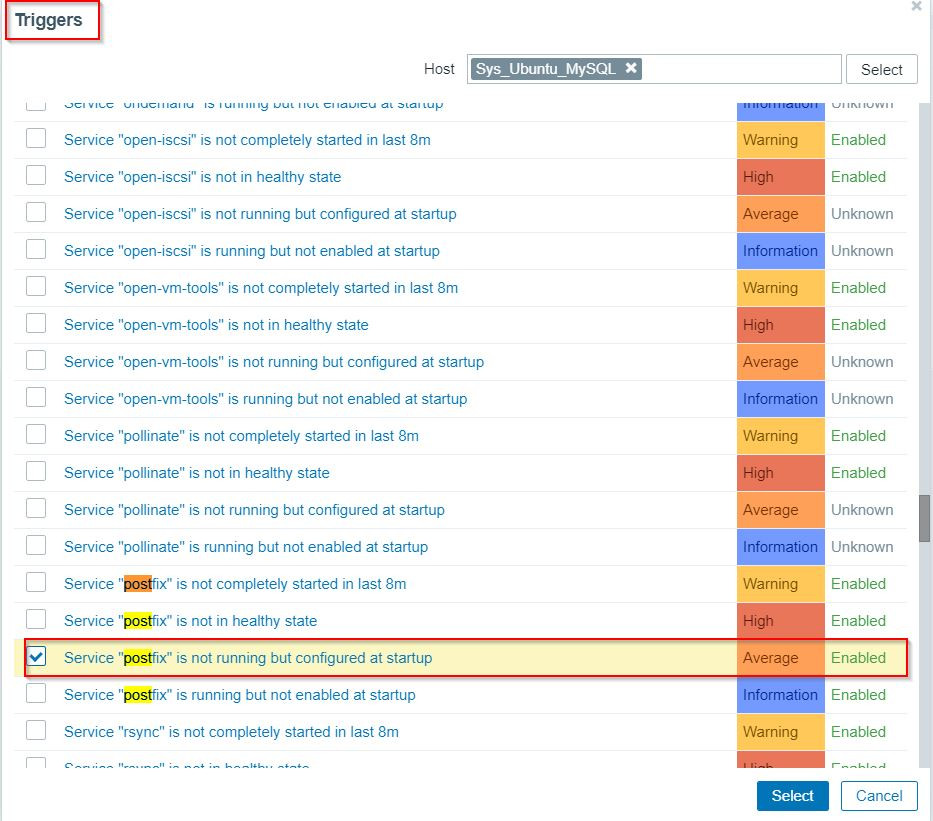

          I mean, I can select directly the trigger in the action condition. It shouldn't allow any error, is this trigger specifies, not the other one.

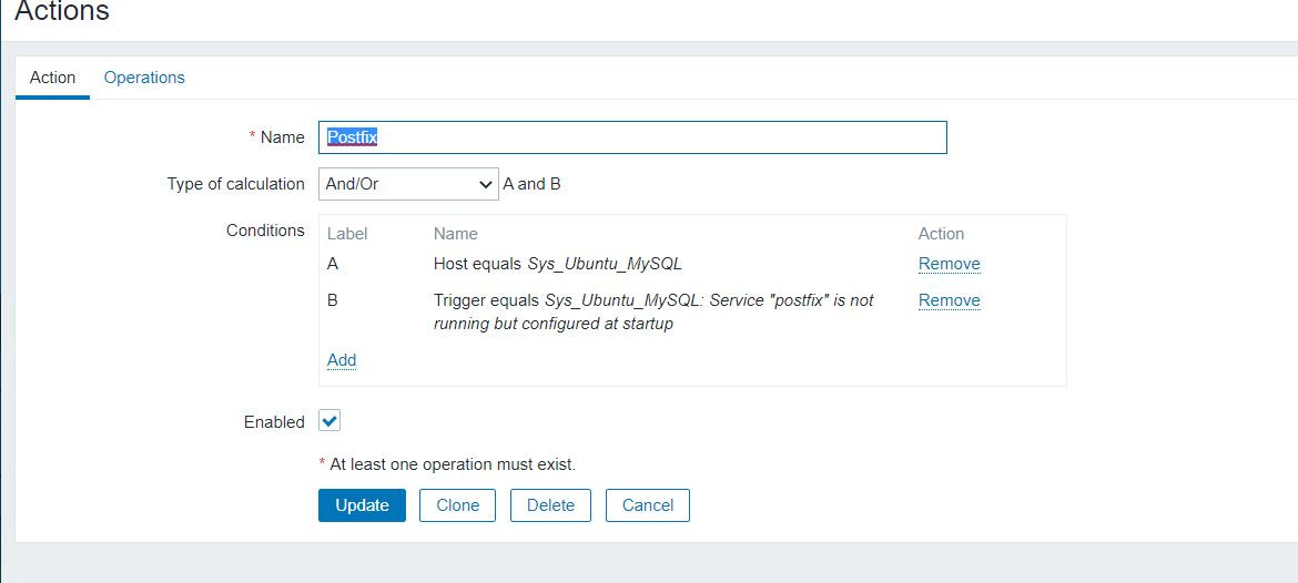

          The action filter only contains the trigger and the host (I tried other items, but it has never worked).

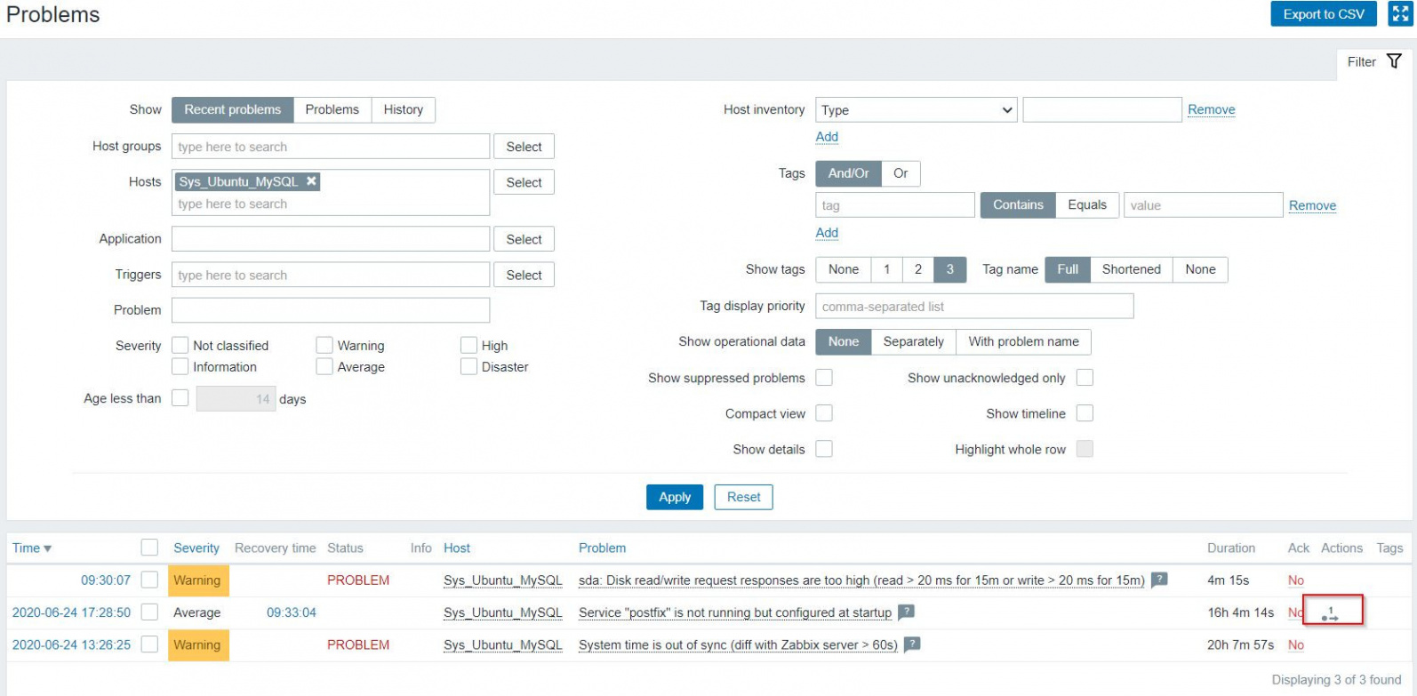

          Do you know what is most estrange for me? When I start the postfix service again in the local server:
          Then, The action is completed. I don't know if this is normal behavior, for me is weird.

            Originally posted by sujiga
            [SIZE=16px][FONT=Arial]Yes, But I still don't understand why it doesn't work.
            You didn't answer the question I asked about how the item was configured, specifically which Application was set.
            That is a different Action than the one that you showed earlier. It no longer contains the "Application contains systemctl" condition. That's why I was asking about your item, and what Application was assigned at the item level
