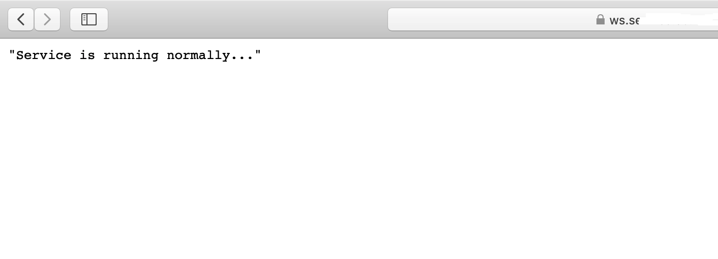

    i need some assistance on how to test / validate if a service is running from a URL.
    for example;
    https://some_url/app
    this link contain n text string: "Service is running normally" or "Service is down" (See Attachment)
    How or what must be done to create a solution that will validate the text and based on this action a trigger if the content changed
    Any help will greatly be appreciated as i have no idea on how to approach this,

    Read up on web scenarios and pay particular attention to the "Required string". I would start by setting up a scenario that looks for "running normally".

      I was able to get the required strings monitored as per you advice.
