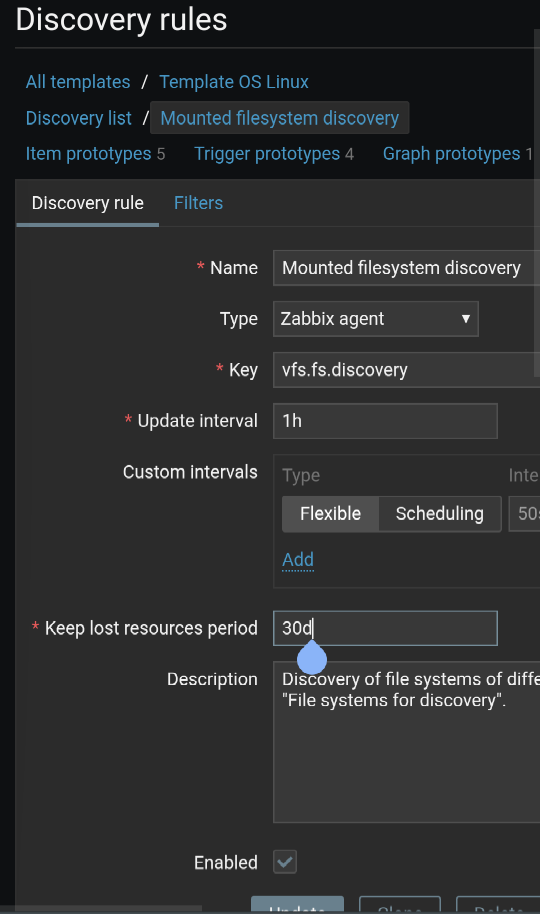

            Log in to zabbix web interface as Super Admin and select Administration - >Queue - >(roll down menu) Details
            and you should see all the delayed items with times and from specific hosts that zabbix server expects to receive. If these items no longer exist (for example a disk partition that is no longer available on a host) you can delete them. You'll find them on the specific host as not available items from auto discovery.
            If you feel that you need to set keep lost resource time to 0 you will find it in the discovery rule of the template you use for your hosts (see attachment).

                looking at your queue your server is waiting for more than 1200 items for more than 1 minute. It is not critical but also not optimal. It also seems that you are using passive zabbix agents - they have worse performance than active agents so consider switching the setup. All you can do now is to increase number of pollers so zabbix server starts to catch up on the queued items.
                Items mentioned in the server log are probably missing from the host. Try to connect to prometheussp and do
                cat /sys/class/net/tap107i0/operstate
                most likely the 'tap' interface no longer exists. If this is the case, you can set the keep lost resource time to 0 (as discussed previously) to fix this problem.

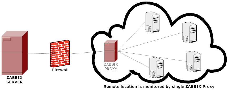

                    I recommend that you read up on the concept of zabbix proxy :https://www.zabbix.com/documentation...concepts/proxy
                    I'm attaching a picture from Google search for zabbix proxy.
                    concept is that the client (zabbix_agent) connects only to the proxy and the proxy connects to the zabbix server. When configuring host on the zabbix web interface you select monitored via proxy (and select appropriate proxy)
