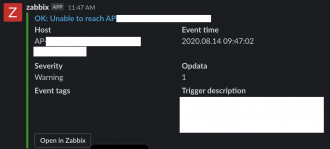

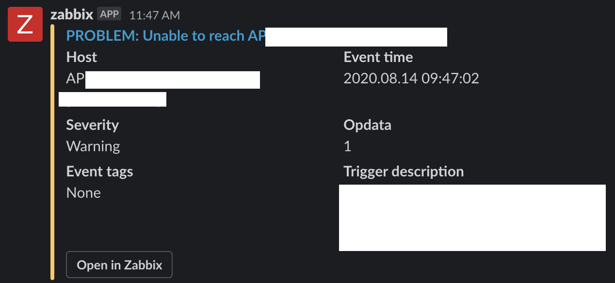

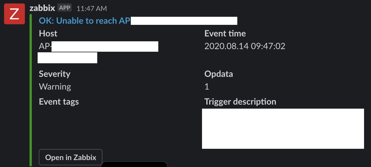

    The 2 slack channels are a public channel called #zabbix-alerts and a private channel called monitoring. Now the issue im facing is that i want to use the "alarm" function of the Slack message meaning that the original "PROBLEM" message will be updated to an "OK" message once the problem has been resolved. This happens for the public channel (See image below):

    But it does not work for the private channel. (it only shows that the problem still exists)

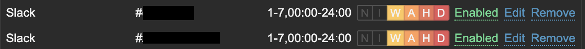

    For both channels i use the same "alert" user with the following configuration for the media:

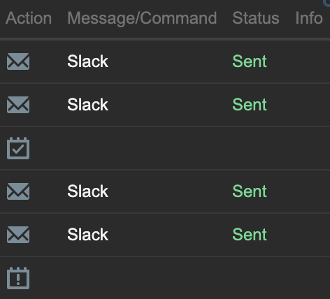

    The Zabbix problem view shows that all of the messages have been sent:
