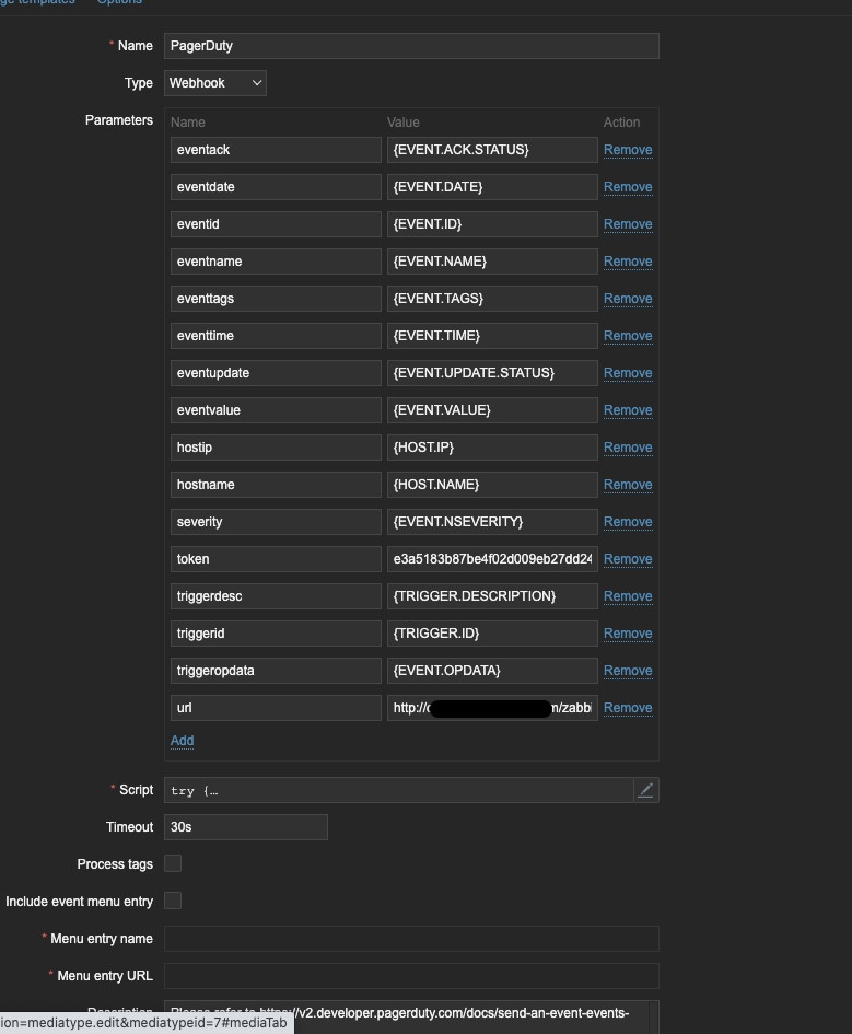

        Hello Everone,
        I am trying to integrate zabbix 5.2 to Pagerduty. I am following the below document. I am no able receive alerts to pagerduty.
        https://git.zabbix.com/projects/ZBX/...edia/pagerduty
        There is an Inbuilt Media type for pagerduty for 5.2 version. So I haven't created a global macro for zabbix url.
        Below is the screenshot for my media type I have used ..can someone validate my config
Name:	Screenshot 2021-04-19 at 1.22.06 PM.jpg
        Appreciate your help here.

        • ajay20kin
          ajay20kin commented
          Able to integrate PD with zabbix 5.0

        I followed that guide and was successful in both 5.0 and 5.2 zabbix versions. What caught me out thought is you have to make sure that your usergroup has at least read permission to the hostgroup you want to alert on.
        What is your Monitoring/Problems showing if you filter for a host that has a trigger and you are supposed to receive alert?
