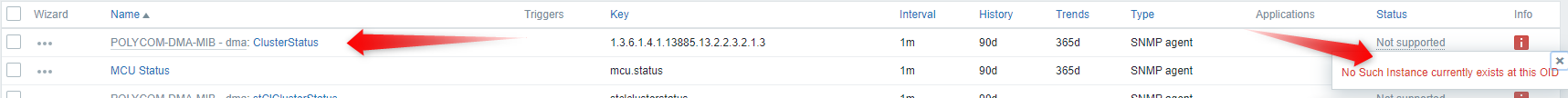

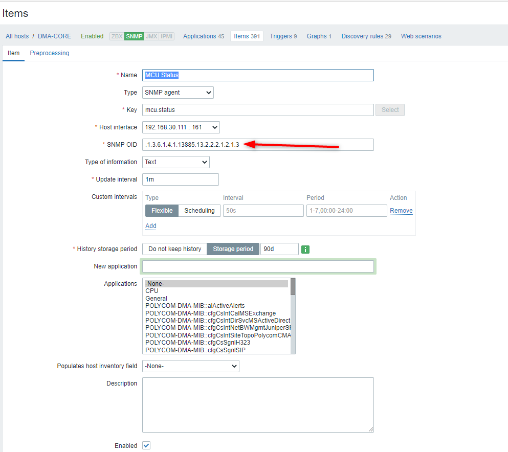

    Hello ,
    I'm trying to create some items in order to monitor Polycom hosts. while using the snmpwalk command , i get the Value as shown in the picture joined , but while creating the item with the same OID in the command , i get the error unsupported OID.
    Could someone help me please ? it's very Urgent

    You are using the wrong OID that snmpwalk displayed to you. Run the snmpwalk with the "-Ona " option. snmpwalk runs down the entire tree from the specified root.
