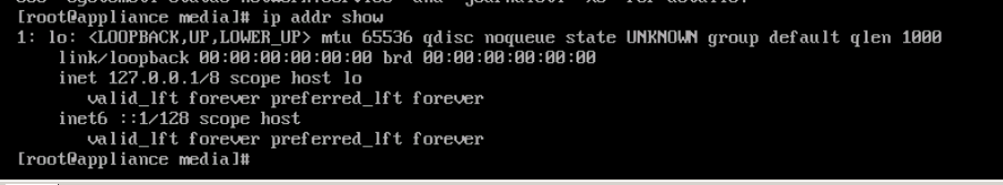

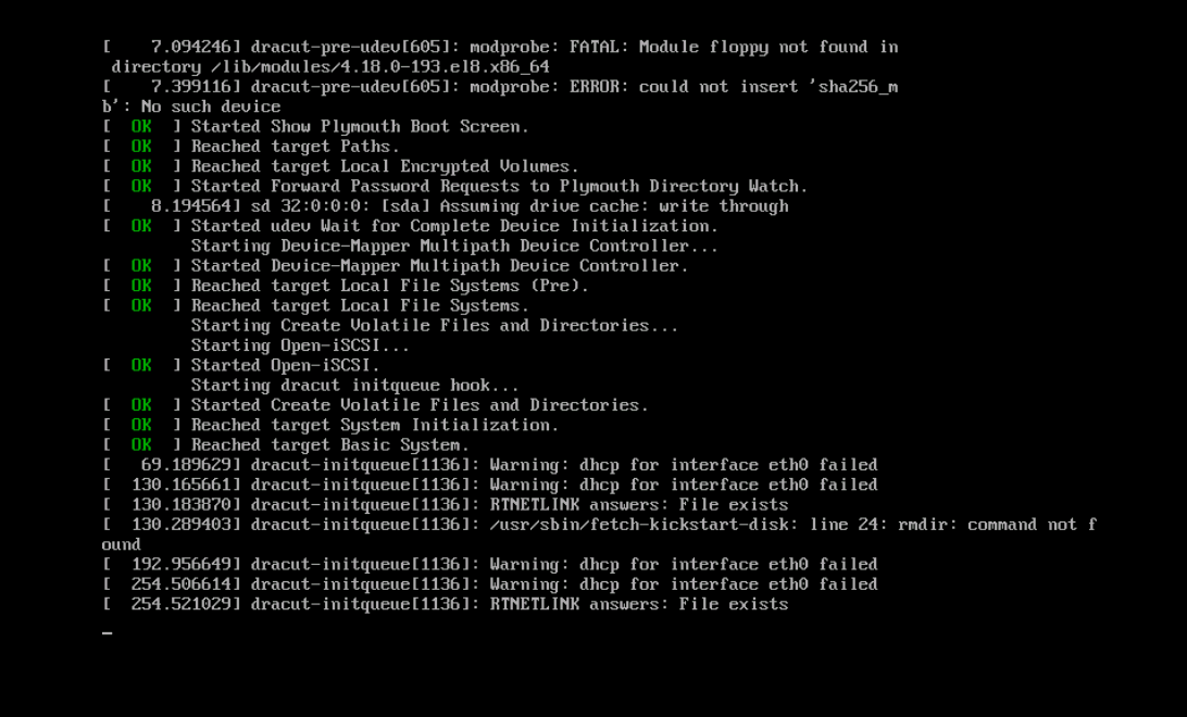

    Deploying via ISO hangs mid install, due to no DHCP being available in our environment, not that it matter since eth0 is not working

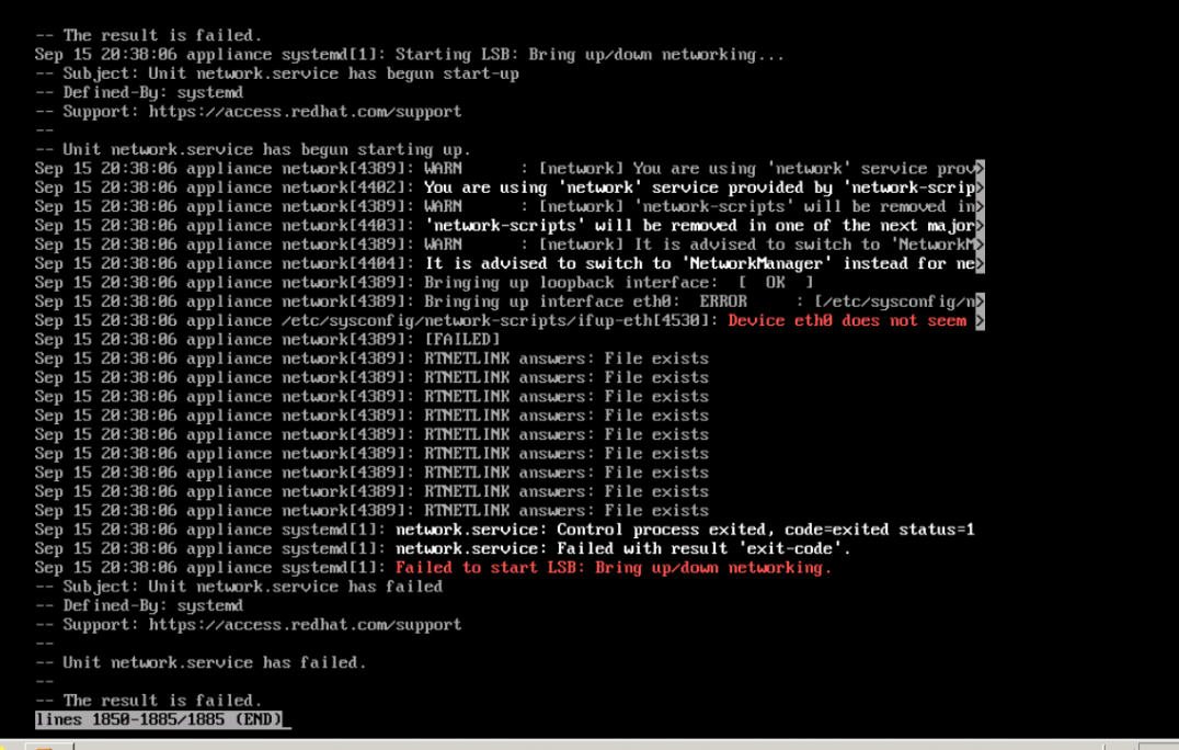

    Deploying via VMX does not work unless you run vmware convertor, then when it turns on, eth0 refuses to come up and network service does not work

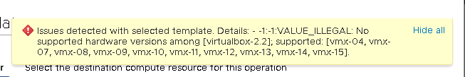

    Deploying via OVF spits out compatibility error

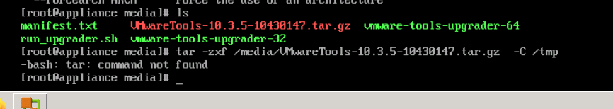

    Tried to install vmware tools to server with no eth0/network service, eventually got it mounted, but now tar isn't installed?
    ESXi 6.7
    I am a windows admin who works well with this product as soon as the UI is working
    Screenshots below. Suggestions on how to get around all this?

    Probably review this: https://www.zabbix.com/forum/zabbix-...working-device
    Also, open-vm-tools is preferred if it's available directly from your Linux distro for your platform. See VMWare's own KB about it: https://kb.vmware.com/s/article/2073803
    • Beveridge
      • Sep 2016
      • 30
      Thank you for this. I was able to get the server up thanks to you. Cheers
