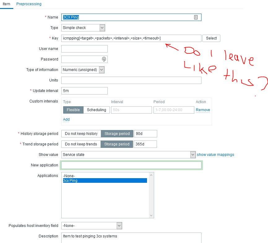

    I have added an Application
    I have added and Item and the setup is in the image. Do i leave the key as it is or do i need to enter details into it?
    • icmpping[<target>,<packets>,<interval>,<size>,<timeout>]
    or
    • icmpping[<8.8.8.8>,<4>,<20>,<24>,<50>]

      Please read the official documentation paying attention to the examples.
      correct - icmpping[8.8.8.8,4,20,24,50]

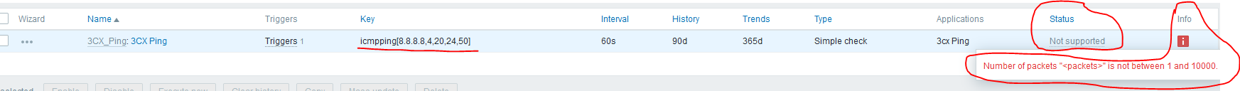

        Hello
        So as above, i have used the string but it still comes back with an error message. How can the info show a packets error, when i have set them??

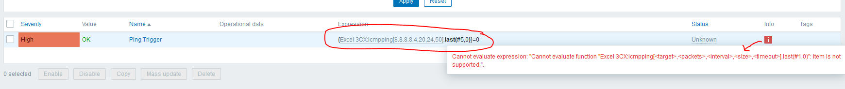

        I also seem to have the same issue with the Trigger string
        Has anyone got any examples they can share based on Zabbix 5 please. Worst case, is their a simplier application to send out pings and alerts on dropouts
        TIA
        • Hamardaban
          • May 2019
          • 2714
          icmpping[‘’8.8.8.8’’,4,20,24,50]
          • eithor
            • May 2020
            • 50
            Make sure that your new config is in place and that the check has run again after the configuration change (you could be seeing an old error message in the GUI).
            To refresh config, run on the zabbix server itself (linux terminal as root):
            zabbix_server -R config_cache_reload
            You can also select the check you want to run and click "execute now" button.
            Note also that the default delay to retry an "unsupported" item is 10 minutes. See under Administration->General->Other...

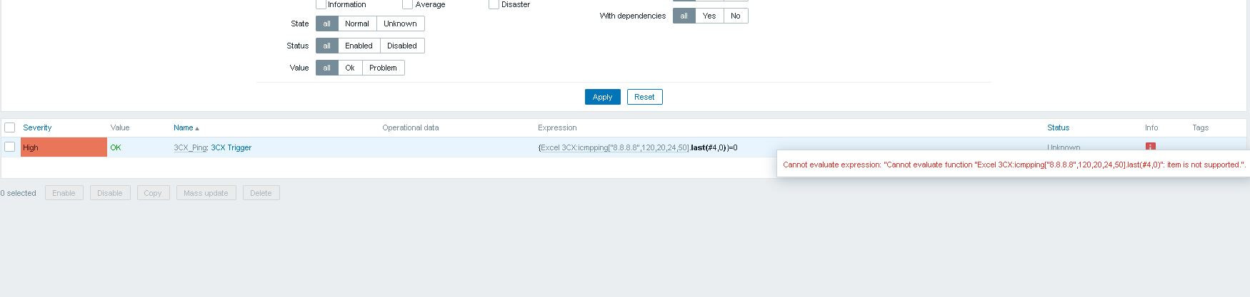

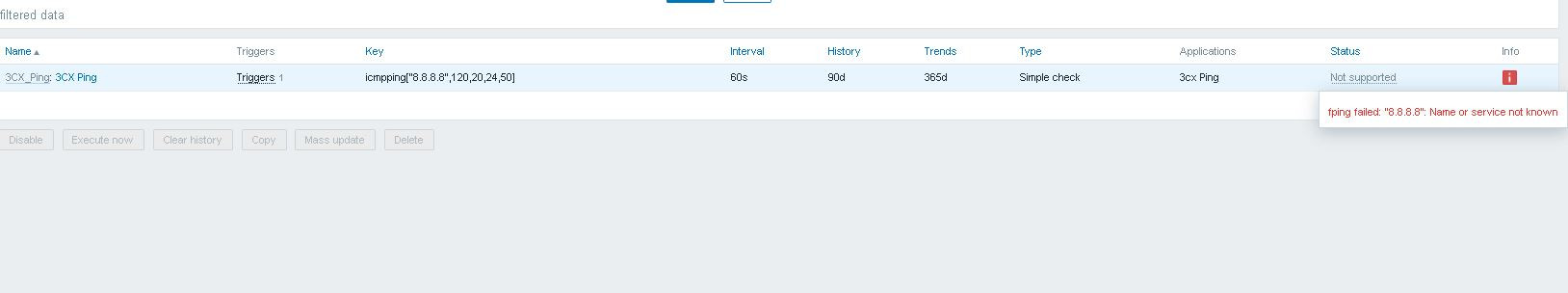

              Trying to setup a ping solution to monitor our customers. For now i am just trying to get it all working using google 8.8.8.8
              The idea is for the system to alert if the ping fails on 2-3 attempts and clears on 2-3 successful pings, if that is possible.
              I seem to have the main issues with the Item string which I am not sure is right - icmpping[“8.8.8.8”,120,20,24,50]
Name:	Item Error.JPG
              Also is the trigger right - {Excel 3CX:icmpping[“8.8.8.8”,120,20,24,50].last(#4,0)}=0
Name:	trigger error.JPG

              • Hamardaban
                • May 2019
                • 2714
                Try using single quotes. Please read the https://www.zabbix.com/documentation...cks#icmp_pings documentation section.
                If you want the zabix server to ping your host, it is enough to specify the icmpping without additional options.
                For the test, if you want the server to ping 8.8.8.8, make a host with this address.
