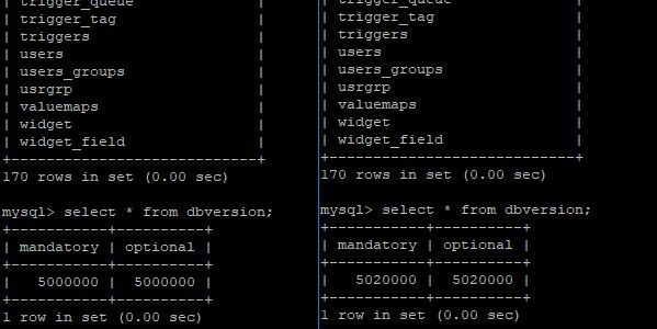

    I had zabbix server 5.0.4 running on one system with php 7.2.0 on ubuntu 18.04 and mysql 5.5 on another system.
    I updated php to 7.3, updated mysql to 8.0 and then updated zabbix 5.0.4 to 5.2, however I am getting this :
    The Zabbix database version does not match current requirements. Your database version: 5000000. Required version: 5020000
    Where have I gone wrong ? Please help ...
    mysql> select * from dbversion;
    | mandatory | optional |
    | 5000000 | 5000000 |
    1 row in set (0.08 sec)
    What changes do I need to perform to make it work ?

      Look at zabbix_server.log, especially the section from after the first time you started up version 5.2.0. Are there error messages there from when zabbix_serverd attempted to update the database schema/version ?
