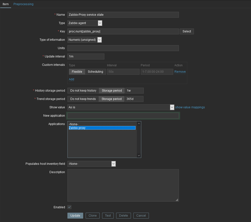

        I just apply the template "Template App Zabbix Proxy" and my own template for Zabbix agent hosts "Basic Monitoring Template" to it.
        I added an item and a new trigger to the Zabbix Proxy application template to see how many processes are runnning of Zabbix Proxy (item key is "proc.num[zabbix_proxy]"). The trigger expression is "{proc.num[zabbix_proxy].last()}=0 or {proc.num[zabbix_proxy].nodata(3m)}=1".
        My "Basic Monitoring Template" has a Zabbix Agent item with the key "agent.ping" and the trigger expression is "{agent.ping.nodata(2m)}=1".
        So when a proxy loses connection or, for whatever reason, the service stops running, I will see it on my dashboard.

            Thanks for the reply is there a possibility you can attach the pictures? of the config? because i see other options like type units it be nice to see the picture of the config

              Here you go:

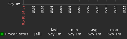

                  For example, "lastaccess" parameter collects this data:
                  Click image for larger version  Name:	proxy_raw_timestamp.png Views:	0 Size:	4.4 KB ID:	438271
                  If using an item's unit of seconds (s), those timestamp values are automatically converted to years, months and so on.
                  Click image for larger version  Name:	proxy_converted_timestamp.png Views:	0 Size:	6.7 KB ID:	438272
                  When using proxy key with "lastaccess" parameter, "fuzzytime()" function actually works and you are able to receive alerts when there's an unavailable proxy.

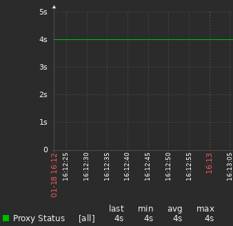

                  If changing item key parameter to "delay", data is more consistent with actual proxy's heartbeat.
                  It seems that, when using "delay" parameter, values represent the real proxy's last seen time.
                  Click image for larger version  Name:	proxy_raw_seen_graph.png Views:	0 Size:	9.1 KB ID:	438275
