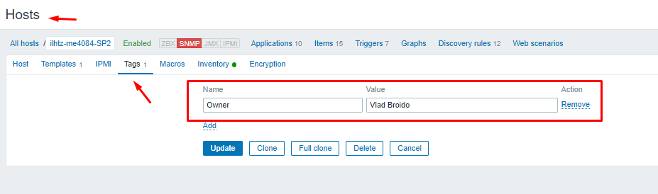

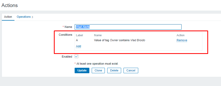

    I'm trying to send an alert by Trigger Action with condition Value of Tag:
    I created a new Tag on Host Level and set my trigger condition but the ​​​alert not arriving
    What I'm doing wrong?

    I'm replying to this old ticket. So yes, I'm trying currently to achieve the same thing.
    After a few tests, currently the condition on the tag value refers to the trigger or item tag value, not the host tag. (To be confirmed.)
    It would be interesting to have a further condition type: "Host Tag Value" which does exactly this.
    Is a host has a tag with a specific tag:value, then the action will be fired. (Only then).
    Example:
    If a host has tag "notify:sms" then the SMS notifications will be enabled for this host.
    This could provide further flexibility, besides the already existing conditions based on Host Group.
    Perhaps there is already a way of doing this?
    Thanks,
      Every event inherits tags from whole chain, host, item, trigger etc... https://www.zabbix.com/documentation...config/tagging
      Actions do not care at which level this is added. From event it is impossible to tell from where tag was added. You can only backtrack it through configuration...
