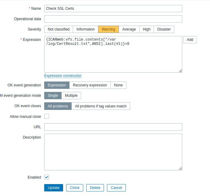

    I also created a trigger as follows.

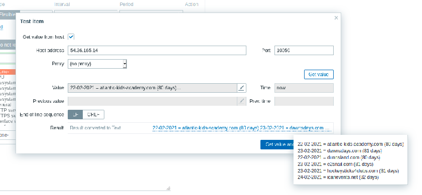

    In the item config, if I run a test I get the needed content of the text file.
    So as far as I understand things. this all works as expected.

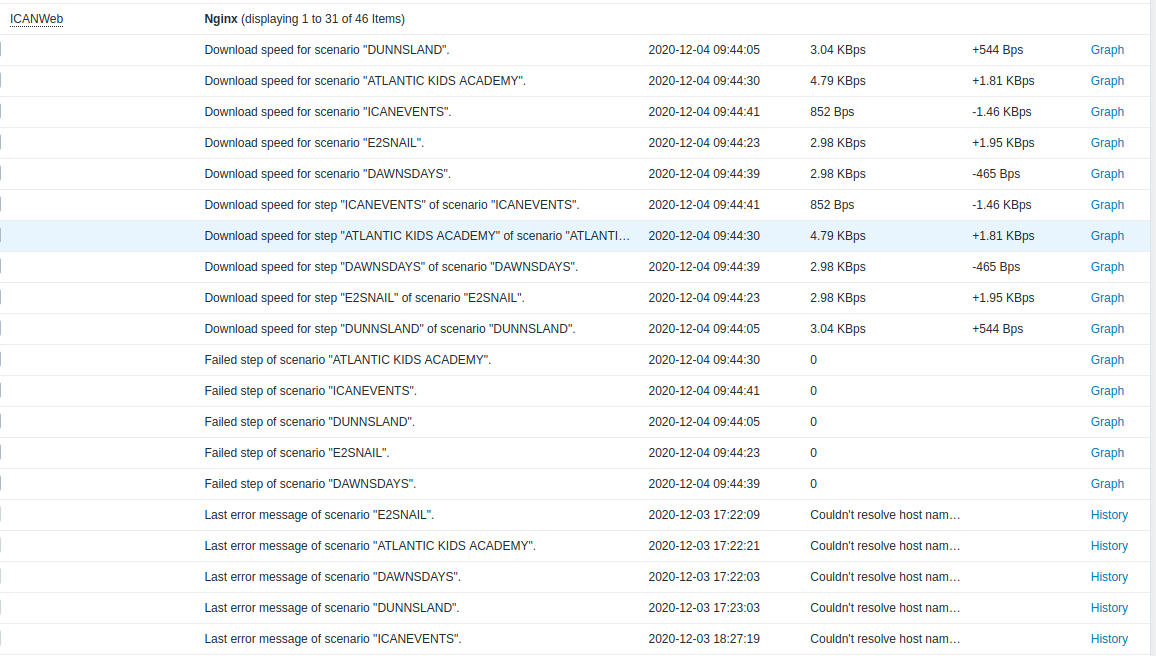

          Sorry for being cheeky but looking at the list below, I see two items that are confusing.
          1. the error "Failed step of scenario" what is this referring to?
          2. the error "Couldn't connect to server: Failed to connect to ${DOMAIN} port 443: Connection refused" - is this a config issue because all teh sites have valid certificates and do open with https.
          ICANWeb HTTPS service (31 Items)
          Download speed for scenario "https://www.atlantic-kids-academy.com". 2020-12-04 13:15:33 159.72 KBps +36.61 KBps Graph
          Download speed for scenario "https://www.dawnsdays.com". 2020-12-04 13:15:33 64.79 KBps +16.74 KBps Graph
          Download speed for scenario "https://www.dunnsland.com". 2020-12-04 13:15:26 28.41 KBps Graph
          Download speed for scenario "https://www.e2snail.com". 2020-12-04 13:14:46 4.92 KBps -5.75 KBps Graph
          Download speed for scenario "https://www.icanevents.net". 2020-12-04 13:15:33 801 Bps -1.42 KBps Graph
          Download speed for step "https://www.atlantic-kids-academy.com" of scenario "https://www.atlantic-kids-academy.com". 2020-12-04 13:15:33 159.72 KBps +36.61 KBps Graph
          Download speed for step "https://www.dawnsdays.com" of scenario "https://www.dawnsdays.com". 2020-12-04 13:15:33 64.79 KBps +16.74 KBps Graph
          Download speed for step "https://www.dunnsland.com" of scenario "https://www.dunnsland.com". 2020-12-04 13:15:26 28.41 KBps Graph
          Download speed for step "https://www.e2snail.com" of scenario "https://www.e2snail.com". 2020-12-04 13:14:46 4.92 KBps -5.75 KBps Graph
          Download speed for step "https://www.icanevents.net" of scenario "https://www.icanevents.net". 2020-12-04 13:15:33 801 Bps -1.42 KBps Graph
          Failed step of scenario "https://www.atlantic-kids-academy.com". 2020-12-04 13:15:33 0 Graph
          Failed step of scenario "https://www.dawnsdays.com". 2020-12-04 13:15:33 0 Graph
          Failed step of scenario "https://www.dunnsland.com". 2020-12-04 13:15:26 0 Graph
          Failed step of scenario "https://www.e2snail.com". 2020-12-04 13:14:46 0 Graph
          Failed step of scenario "https://www.icanevents.net". 2020-12-04 13:15:33 0 Graph
          HTTPS service is running 2020-12-04 13:15:32 Up (1) Graph
          Last error message of scenario "https://www.atlantic-kids-academy.com". 2020-12-04 12:34:14 Couldn't connect to server: Failed to connect to www.atlantic-kids-academy.com port 443: Connection refused History
          Last error message of scenario "https://www.dawnsdays.com". 2020-12-04 12:34:18 Couldn't connect to server: Failed to connect to www.dawnsdays.com port 443: Connection refused History
          Last error message of scenario "https://www.dunnsland.com". 2020-12-04 12:34:20 Couldn't connect to server: Failed to connect to www.dunnsland.com port 443: Connection refused History
          Last error message of scenario "https://www.e2snail.com". 2020-12-04 12:34:41 Couldn't connect to server: Failed to connect to www.e2snail.com port 443: Connection refused History
          Last error message of scenario "https://www.icanevents.net". 2020-12-04 12:47:25 response code "404" did not match any of the required status codes "200" History
          Response code for step "https://www.atlantic-kids-academy.com" of scenario "https://www.atlantic-kids-academy.com". 2020-12-04 13:15:33 200 Graph
          Response code for step "https://www.dawnsdays.com" of scenario "https://www.dawnsdays.com". 2020-12-04 13:15:33 200 Graph
          Response code for step "https://www.dunnsland.com" of scenario "https://www.dunnsland.com". 2020-12-04 13:15:26 200 Graph
          Response code for step "https://www.e2snail.com" of scenario "https://www.e2snail.com". 2020-12-04 13:14:46 200 Graph
          Response code for step "https://www.icanevents.net" of scenario "https://www.icanevents.net". 2020-12-04 13:15:33 200 Graph
          Response time for step "https://www.atlantic-kids-academy.com" of scenario "https://www.atlantic-kids-academy.com". 2020-12-04 13:15:33 454.89ms -134.97ms Graph
          Response time for step "https://www.dawnsdays.com" of scenario "https://www.dawnsdays.com". 2020-12-04 13:15:33 66.24ms -23.06ms Graph
          Response time for step "https://www.dunnsland.com" of scenario "https://www.dunnsland.com". 2020-12-04 13:15:26 67.4ms +0.053ms Graph
          Response time for step "https://www.e2snail.com" of scenario "https://www.e2snail.com". 2020-12-04 13:14:46 193.17ms +103.66ms Graph
          Response time for step "https://www.icanevents.net" of scenario "https://www.icanevents.net". 2020-12-04 13:15:33 202.87ms +130.22ms Graph
          Thanks in advance

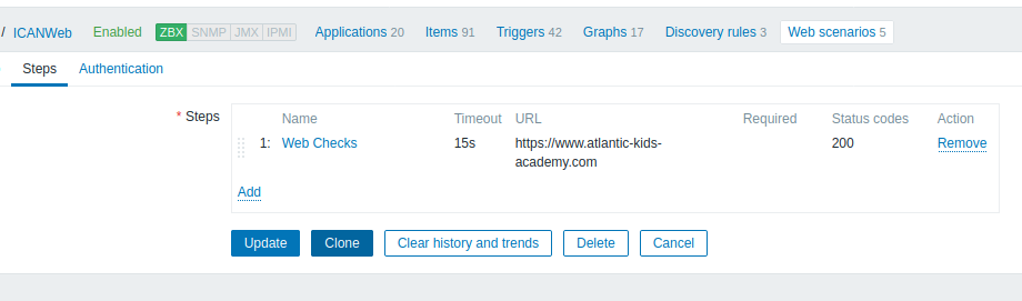

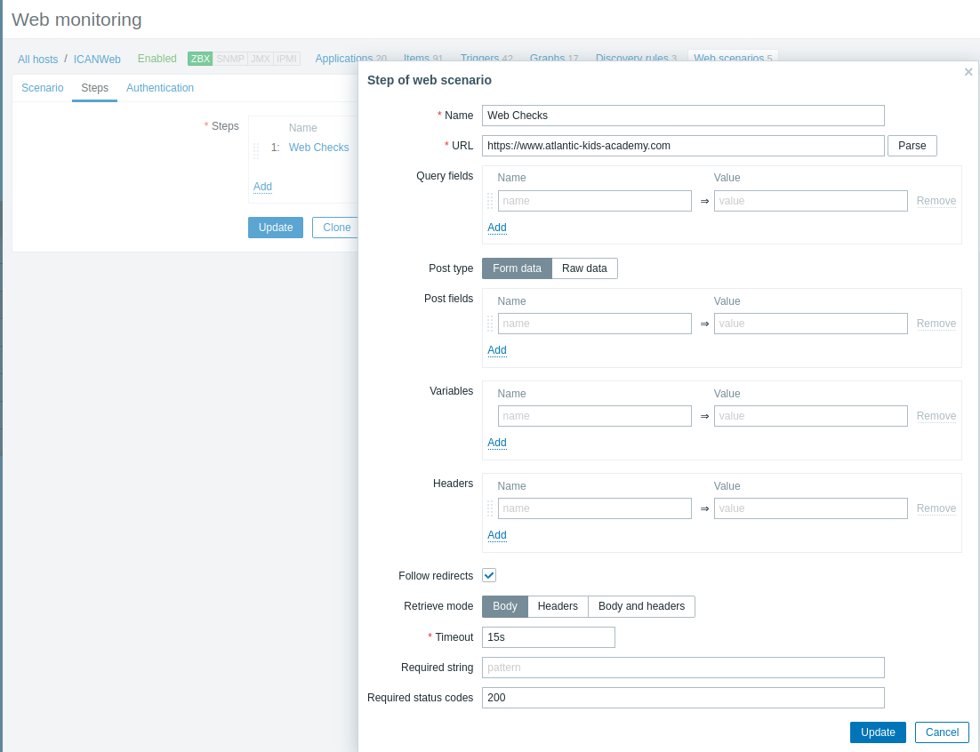

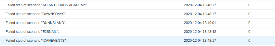

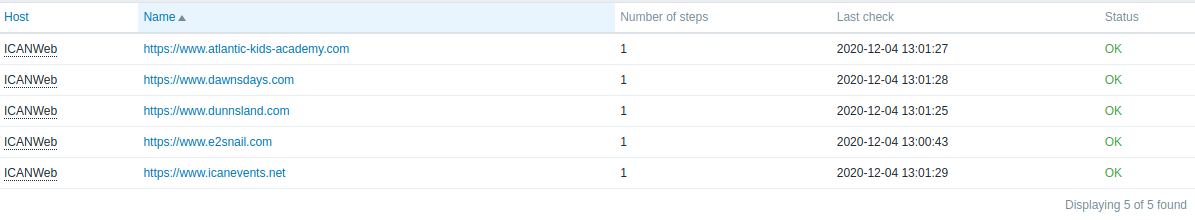

              cyber Thanks for your reply. I did a check and I only have 1 step and as far as I can gather that is successful, according to what you say if there is a "0" then failure should not be present.
              Click image for larger version  Name:	step1_scenario.png Views:	0 Size:	77.4 KB ID:	414628
              Step #1
              Click image for larger version  Name:	step1.png Views:	0 Size:	30.5 KB ID:	414629
              and yet I still see the failure. Also looking at what you said about the value being a "0", looking at the latest data it is showing a "0" so why is it showing as a failure?
              Click image for larger version  Name:	last_data_failed.png Views:	0 Size:	24.7 KB ID:	414630
              A little confusing.
              Lawrence

                      • Matgou
                        • Nov 2020
                        Hi cyber and lslamp,
                        I'm not sure but data can't be displayed if you select : "do not keep history" in item definition.
                        You know with this configuration, dependents items are evaluated, but history table doesn't have any data about this item. In the "Latest data", you don't see this item because you must check "Show items without data" to see it but it will be empty.
                        So, define a storage period and you will see your data. If you don't want many data for this item, add a preprocessor step with : "discard unchanged".
                        Regards,
Name:	Capture d’écran du 2020-12-09 21-45-26.png

                          Thanks for your input, but can you please clarify something. If I have created the item and set a storage period, do I need a trigger?
                          The reason I am asking is because looking at the trigger I see an error that says not enough data.
                          That makes no sense to me cause there are no other input fields where I can add any more data.
                          as a test I will remove the trigger and see what happens.

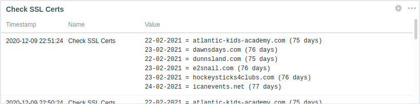

                          • lslamp
                            • Jan 2020
                            • 33
                            Matgou
                            I removed the trigger and now I have the following display
                            I have added an extra line in the text file to push the half cut off line away out of shot.
                            I am happy. It works now thanks.
                            Seems I was making it more complicated than was necessary.
                            Thanks for the pointer
                            Lawrence
                            • Matgou
                              • Nov 2020
                              #15
                              lslamp
                              Item collect data and trigger evaluate item's data to create problem. And If I correctly understand your issue, you don't need to perform any check on your file content, because you don't want any alert., just display.
                              So trigger wasn't need but the trigger wasn't block data displaying.
                              If trigger become "unsuported" and display an errror : "not enough data", it's not a error in your configuration but it's with item data (history). Here you build a trigger to check if the "#1" last item data are equal to "0" (so if file content equal to "0"), your item didn't have any history data, so the check couldn't be perform.
                              Take care,
