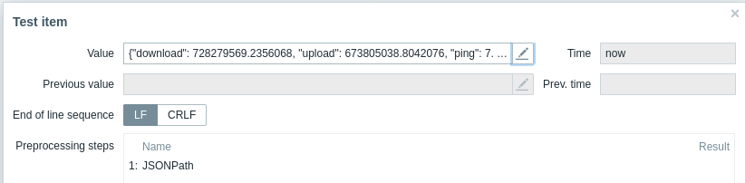

    I think you use Test with incorrect value. In "Test Item" screen you should set JSON data in Value field like :
Name:	Capture d’écran du 2020-12-09 13-21-01.png
    Best,
    Mathieu

      thanks for your pointer. This solved my problem.
