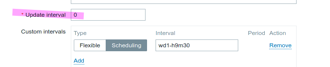

    Hello
    im trying to schedule a test to run at 23:30 everyday except Saturday the schedule looks like this wd1-6h23m30
    but it doesn't work it runs every minute as update interval
    the schedule is wrong?
    the item type is HTTP AGENT
    zabbox 5.0.5
    help plsss

    pls, share screen of your item configuration
    you might also check update interval and set it to 0 - while scheduled interval at your desired time

    • ZMS
      • Nov 2020
      • 19
      this is the config
      i did change the update interval to 0 as you said and and the update every minute stopped .
      but now i have another problem
      i want the check to be at all days except Saturdays
      1-6 the right config?

        use the button "Add" - youll have 2 rows for custom intervals - set 1st wd1-5h23m30 and 2nd wd7h23m30
        • ZMS
          ZMS commented
          genius!
          thanks a lot
        "wd1-5,7h23m30" should also work
