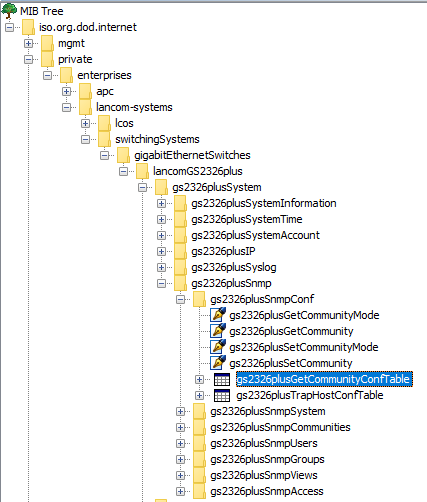

    The only way you could maybe achieve that is by using SNMP or any other type of script to create the user, group, view and access on each device automatically.
    For example, Lancom devices have something like this in one of their MIBs. But don't ask me how to do this or write a script for it - I think am as clueless as you. This is the .1.3.6.1.4.1.2356.800.3.2329.1.6 MIB. There are some read/write objects for SNMP configuration:
    • NilsA
      • Sep 2020
      • 102
      You need to obviously check if there is any MIBs like this for your devices.
